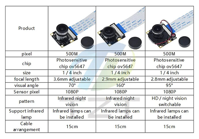

Wanna build a project where the rock 4 looks for movement, but since it will be outdoors tracking animals, i’d like it to react on IR movements and not just “pixel changes”
Any good suggestions for hardware?
For example, how about the RPi’s camera “Pi - IR-CUT 5MP”?
If anyone of you have done someting similar i’d love some inputs for hardware.
I tested it long ago on Rock 3A and it worked. I can’t say it will work on all Rock 4 versions.
I have read here and there kernel 5.10 supports imx219 with calibration / tunning file, search for a similar product but with an imx219 sensor.
Check if you can run kernel 5.10 on your Rock 4 and if so go for the imx-219 sensor.
