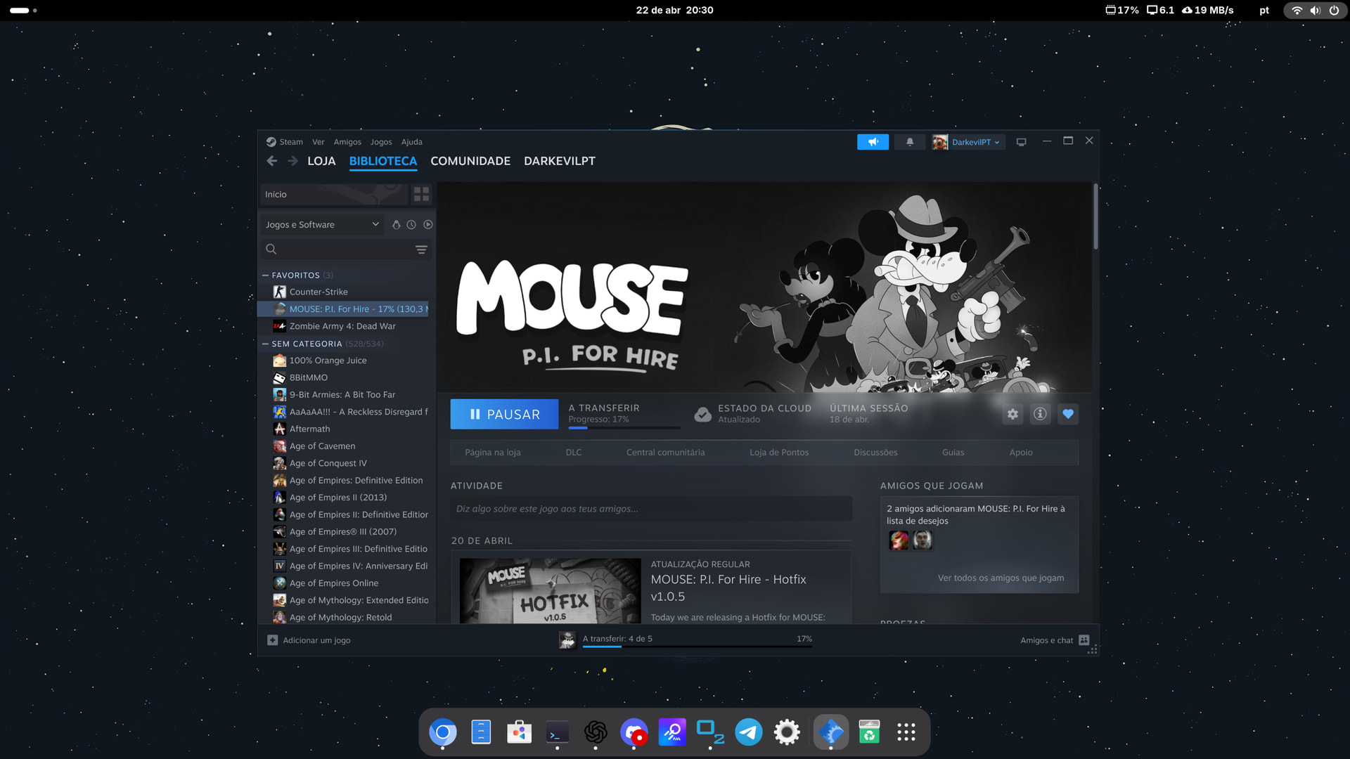

steam #just wait.
Installation is now finished EnJoy!

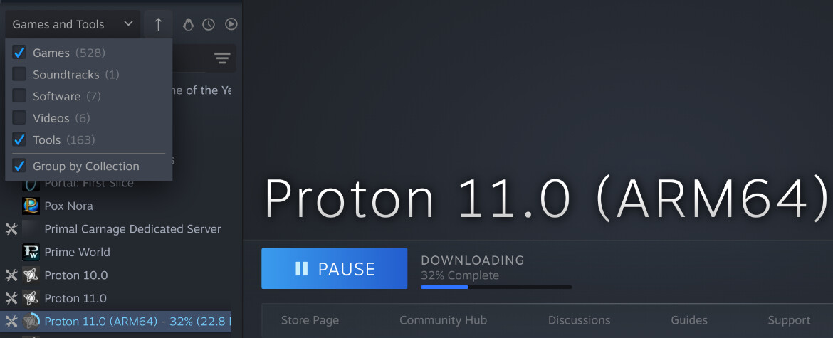

For all games set settings to -force-opengl and maybe install proton experimental like always… after installing steam perform a steam restart bugs may follow and retry is key.
