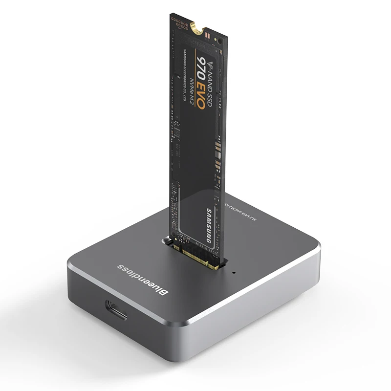

so I want to install openfyde to NVMe, any idea? I ā€œpowerwashā€ my ā€œtry it nowā€ openfyde as I cannot find the install option to do it all over again. My H20 32GB Optane + 512GB QLC is detected with the 32GB (27GiB) portion only within openfyde, no problem, and I want to install to this part of the drive anyway. Press install, wait, shutdown, remove 12V power and then uSD card, connect power again, and the screen never show up, though LED is blue (boot should be fine).
I cannot do serial console debug for boot right now… any idea that the installation is wrong ā€œsomewhereā€? I also flashed debian to another uSD, and just in case reflashed the non-debug version of SPI following the guide, no problem with md5 check. just in case again, lspci shows the optane portion is detected okay when I’m in debian. my guess is that the bootloader cannot ā€œswitch overā€ to the NVMe drive? should I use the Armbian NVMe bootloader instead? or UEFI for rock 5B? for now I can just ā€œkeep trying outā€ā€¦ I still plan to have Android apps running on it… I also bought a fingerprint reader for Android apps that require touch ID, just waiting for openfyde to be installed ā€œproperlyā€ā€¦ on uSD it is way toooooooo slow, at least on the older card.
Usually I select what type of storage I want mt system to work from… either microsd emmc or nvme…and try to focus on that…
So lets say you want fyde on nvme… means u have to flash your nvme. If you want to flash just a partition of your nvme it probably needs to be in exfat4 !
idk if you remember the process with armbian… users would flash emmc cards with it then wanted to move it to the nvme… the process itself could be achieved with the armbian-config on terminal but would also require a new spi flash for that instruction.
Best solution I came up for the nvme was to flash the nvme straight dead on with an enclosure:
Works like magic. But for partitions and what not… I got no clue…
From my experience running fydeOS or openFyde from an MicroSD is only slow on the first setup initiation after you login into the system working in it / it was dead on… pretty fast actually… obviously emmc is more reliable. But the dd process from the fyde installation app is supposed to work but requires the nvme to be on some certain format of which I cant remember…
