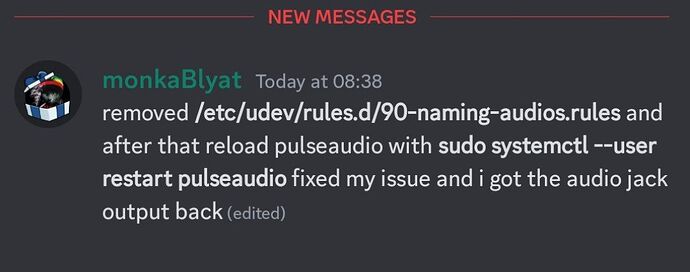

but what I recognize: if select ā€œHeadphone - ES8316 Audioā€ while playing webradio the progress bar below is working, but no sound. It seems for me the must be anywhere a controller is muted.

Okay, I’ve tried this: still no sound on speaker , just progress bar is working. The naming of output device was changed.

Audio via jack I dont own any device to try. Apologies @linuxfriend :frowning: you have to keep trying. Or try the previous monkas version (the one that includes steam) that might be working if the mistake is due to some update misplaced… Test it

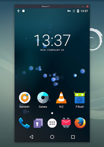

Install scrpy version 2.0 that is needed for audio forwarding from the android docker container
sudo nala install ffmpeg libsdl2-2.0-0 adb wget gcc git pkg-config meson ninja-build libsdl2-dev libavcodec-dev libavdevice-dev libavformat-dev libavutil-dev libswresample-dev libusb-1.0-0 libusb-1.0-0-dev -y
git clone https://github.com/Genymobile/scrcpy
cd scrcpy
./install_release.sh
Change it to english this way. Just drag and drop your .apk file into the android window it will auto install it.
https://streamable.com/2xqx8b
Start the Android Emulator on Terminal:
malior-droid
adb connect localhost:5555
scrcpy -s localhost:5555
App to map the gamepad controller sudo apt install antimicro
