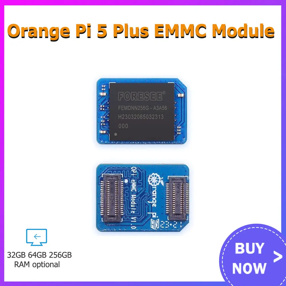

Ive only tried on the emmc and ive heard some microsds wont work on rock 5a Id say for you to get one of these
Update:
I havent used the M2. Only emmc. Maybe something is wrong with your board.
