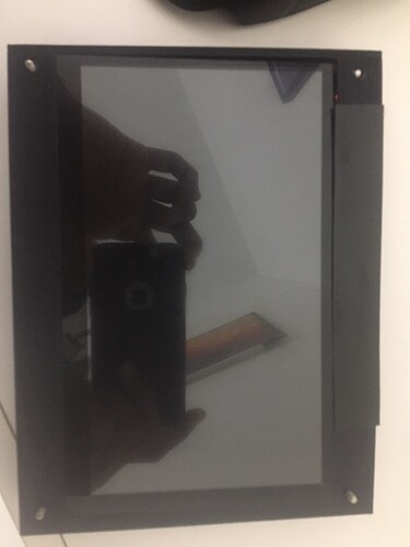

Hi, Thanks you soo much. i see the efifb picking up now.
Just have one small query. I’m trying to load it on a home made portable device with display of resolution 1024x768. So, its showing backlight for 2 sec and going off.
Any suggestions on the how to change the resolution from 1960x1080 to 1024x768!
I tried kern.vt.fb.default_mode=“1024x768”. but didnt work. :frowning:
Should i recompile the image? I am ready to try, but can you please point me where i can change in crochet code base.
Really appreciate your help!
This is the diy device i’ve made.. :slight_smile:
Hi
It doesn’t work like that
root@pinebook:~ # sysctl kern.vt.fb
sysctl: unknown oid 'kern.vt.fb
kern.vt.splash_cpu_duration: 10
kern.vt.splash_cpu_style: 2
kern.vt.splash_ncpu: 0
kern.vt.splash_cpu: 0
kern.vt.kbd_panic: 0
kern.vt.kbd_debug: 1
kern.vt.kbd_reboot: 1
kern.vt.kbd_poweroff: 1
kern.vt.kbd_halt: 1
kern.vt.suspendswitch: 1
kern.vt.deadtimer: 15
kern.vt.debug: 0
kern.vt.enable_bell: 1
kern.vt.enable_altgr: 1
root@pinebook:~ #
I think for your device you need to build a special U-boot
in which you can fix the screen resolution you need
What interface does the EDP screen have?
Oh, Thanks for the clue. It’s normal hdmi screen! I will go through the uboot configuration and get back.
