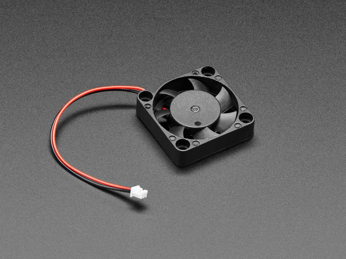

That is showing a 3pin fan but we are talking about the onboard 2pin fan header that is pwm controlled based on the measured temp by software.

PS I really struggled to source fans with this connector so ended up getting these
https://www.ebay.co.uk/itm/194901336522?var=494809760477
