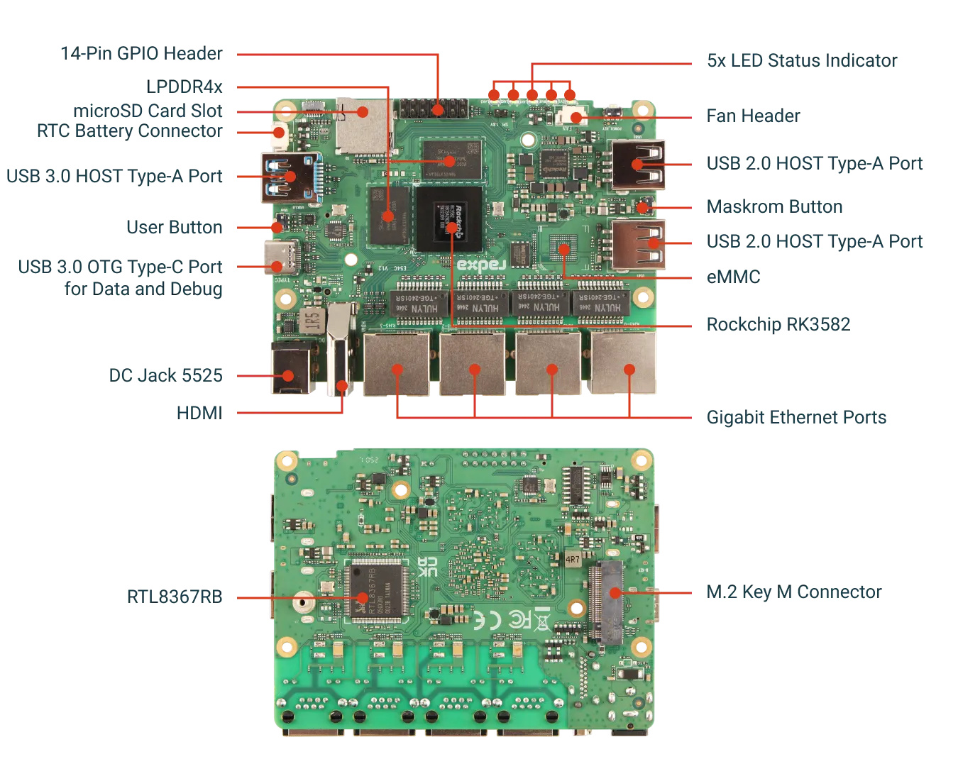

Please check the picture below:
There is one USB 3.0 A port, and the USB C port is a combo port, which has USB 3.0 HOST capability but no USB 2.0 host. It has USB 2.0 device capability. If you connect a USB 3.0 type C hub, it will work in 3.0 mode.
