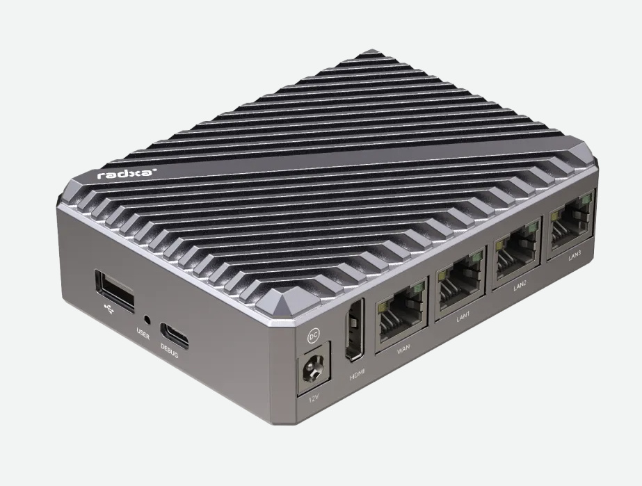

Take a look at E54c, this one has four ethernet ports and nice case,
Or 5T with two 2.5G ethernet ports

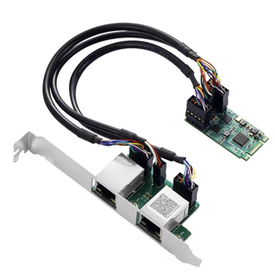

If You already have 4B+ it’s also possible to get more connectivity there using m.2 slot. This cheap card should give two extra 2.5G ports:

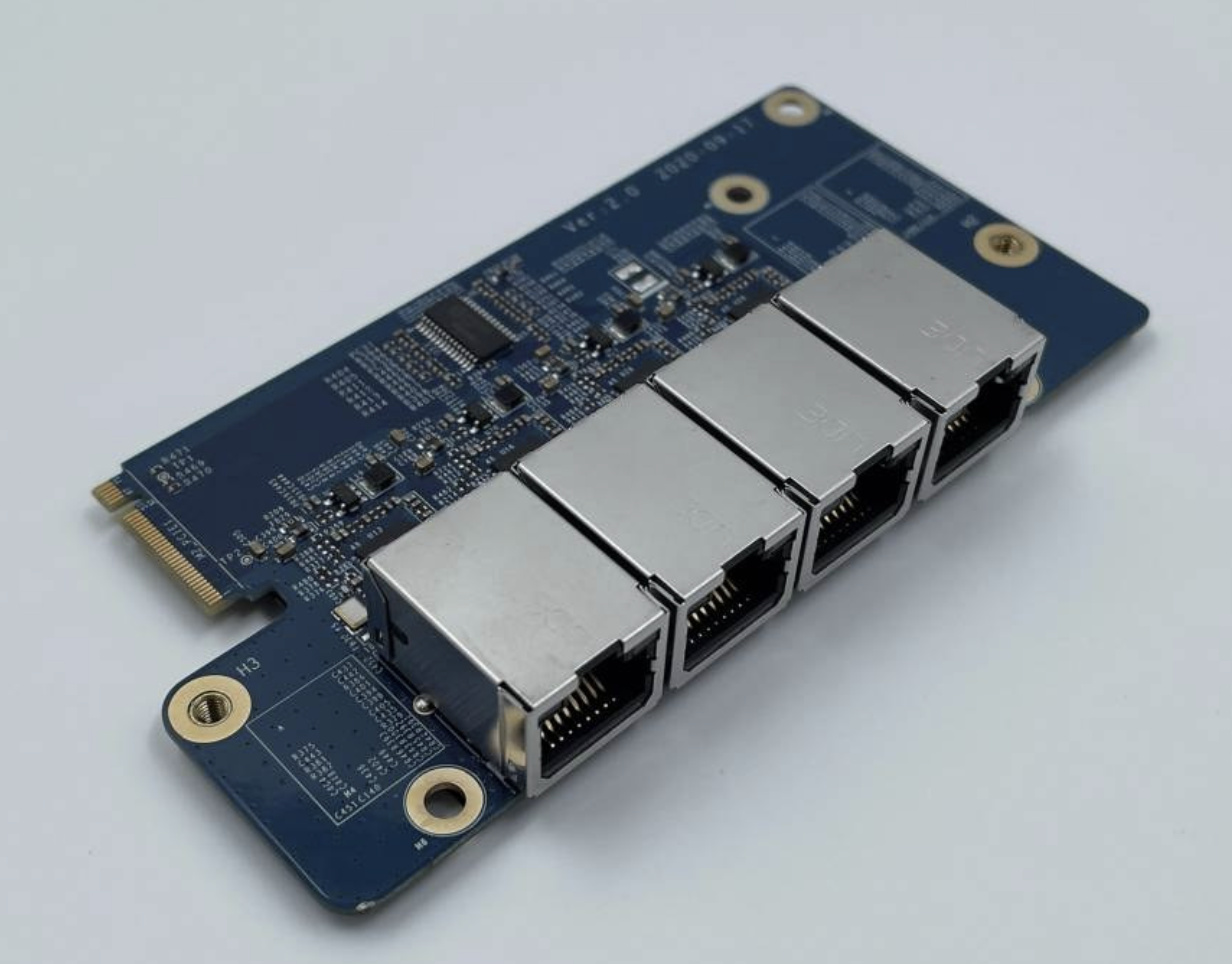

There was also odroid net card with four ports:
…but as far as I remember it requires 1+1+1+1 bifurcation and that’s probably not possible on Rock4,

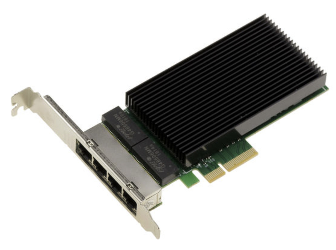

Also You can convert Your m.2 into regular pcie slot and get one of those:
(it will make Your setup large and bulky, probably not worth it!)
