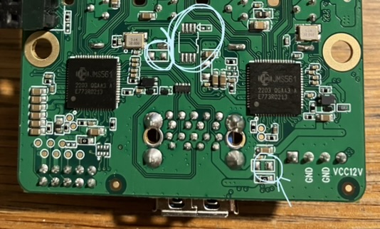

Hello, I purchased a DK005 Quad SSD SATA HAT kit, and this is already the second unit that does not work. There is no dmesg output, and it also does not appear in lsusb. Supplying 12 V power makes no difference, and it is not detected on a different Raspberry Pi 4 either. The USB bridge was, of course, connected. Upon inspecting the PCB, it appears that diodes or jumper links are missing, as well as a 3.3 V voltage regulator for the two USB-to-SATA controllers.

Hey, not sure if it is too late. I had the same issue and the same board with those components missing. I eventually figured out that it is because of the gpio version. I got it work by downloading the new version of rockpi-quad. The code is like
