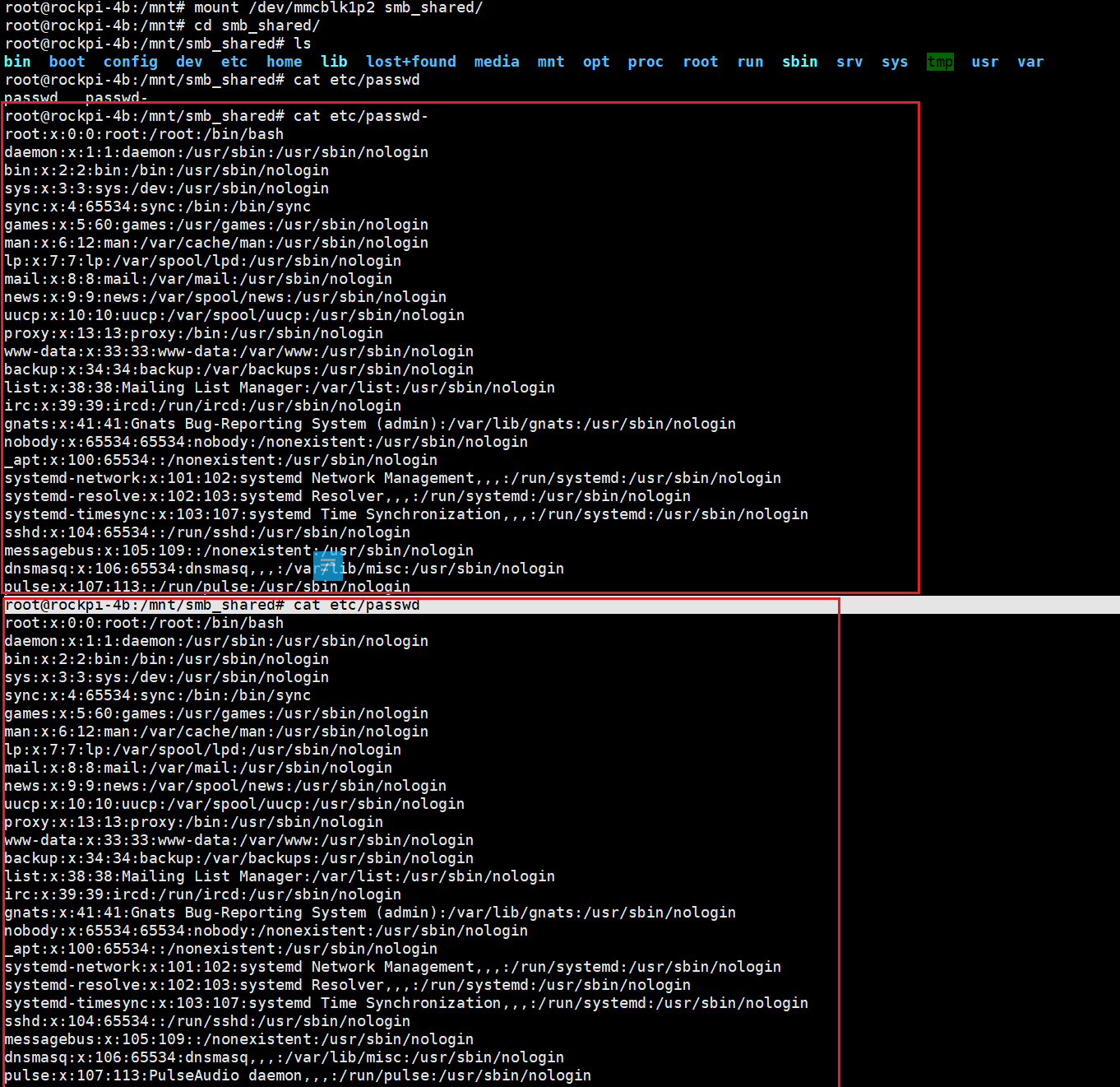

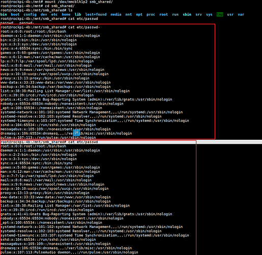

It’s also a 4B+, after I wrote the image and mounted the root (/) partition of the new image, I checked the passwd file and found that there were no relevant user accounts at all!
Account is created on the first boot.
