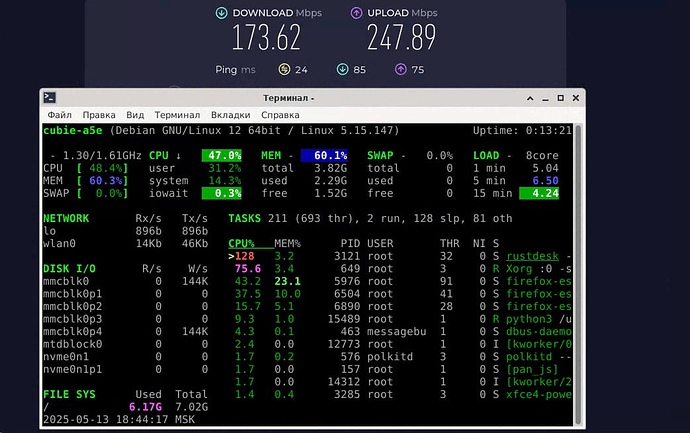

User xenomorph on radxa discord said he replaced the antenna and got better speeds I recall someone saying that max transfers were ‘locked’ at 80mbs or so.
Antennas won’t help with ethernet
and so its the ethernet speed thats crap?
No. Just read the full thread, the problem is solved.
