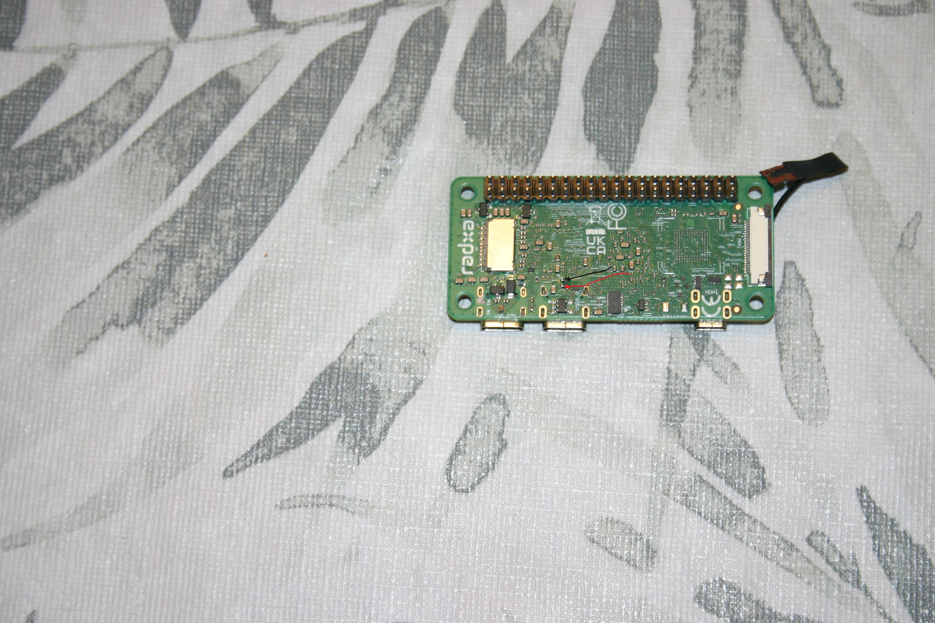

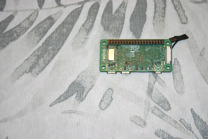

I had to take apart my Eachine Sphere VRX (Hdmi) version as the antenna wire had an issue.
Problem is two wires popped off the radxa board so I need to solder them back on. I have a second picture that shows the two wires and first one without where I show red and black lines where I think they go. I just hoping some one can confirm?

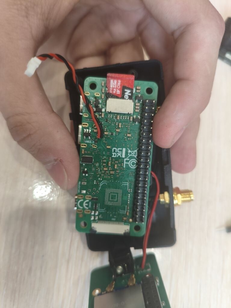

On another issue I wanted to try RubyFPV but it needs a USB port that supports a usb memory stick. One on banggood said he disconnected the usb sbus ie: Everything is great,the device is functioning. I ran into a problem: in the extreme USB-C port on the RubyFPV nothing is detected,and you have to go inside to disconnect the USB bus,and only then is the USB-C in the center finally recognizing the flash drive. I recommend detaching the USB bus from the back of the SBC board and making it a through-line via a proper Type-C for convenience. Can someone explain how to do that?
Found out the red and black wire are for data from the wireless board. Looks like they are soldered to a component instead of a solder pad. Kind of ugly method if true.
