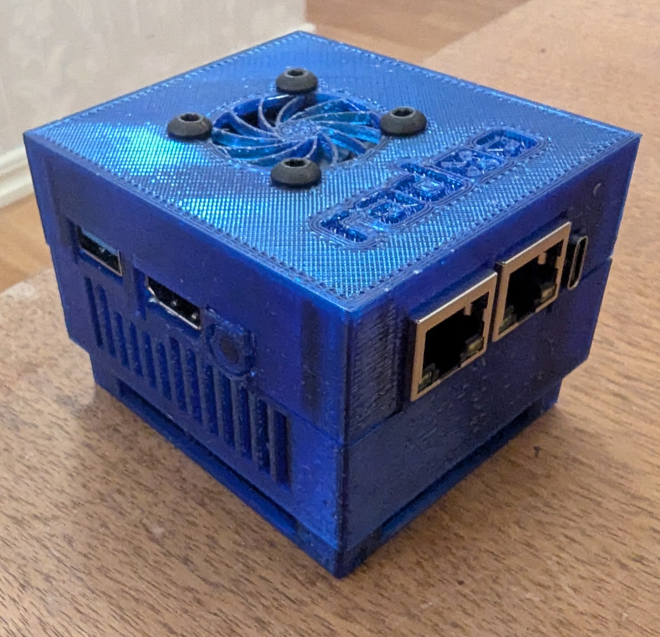

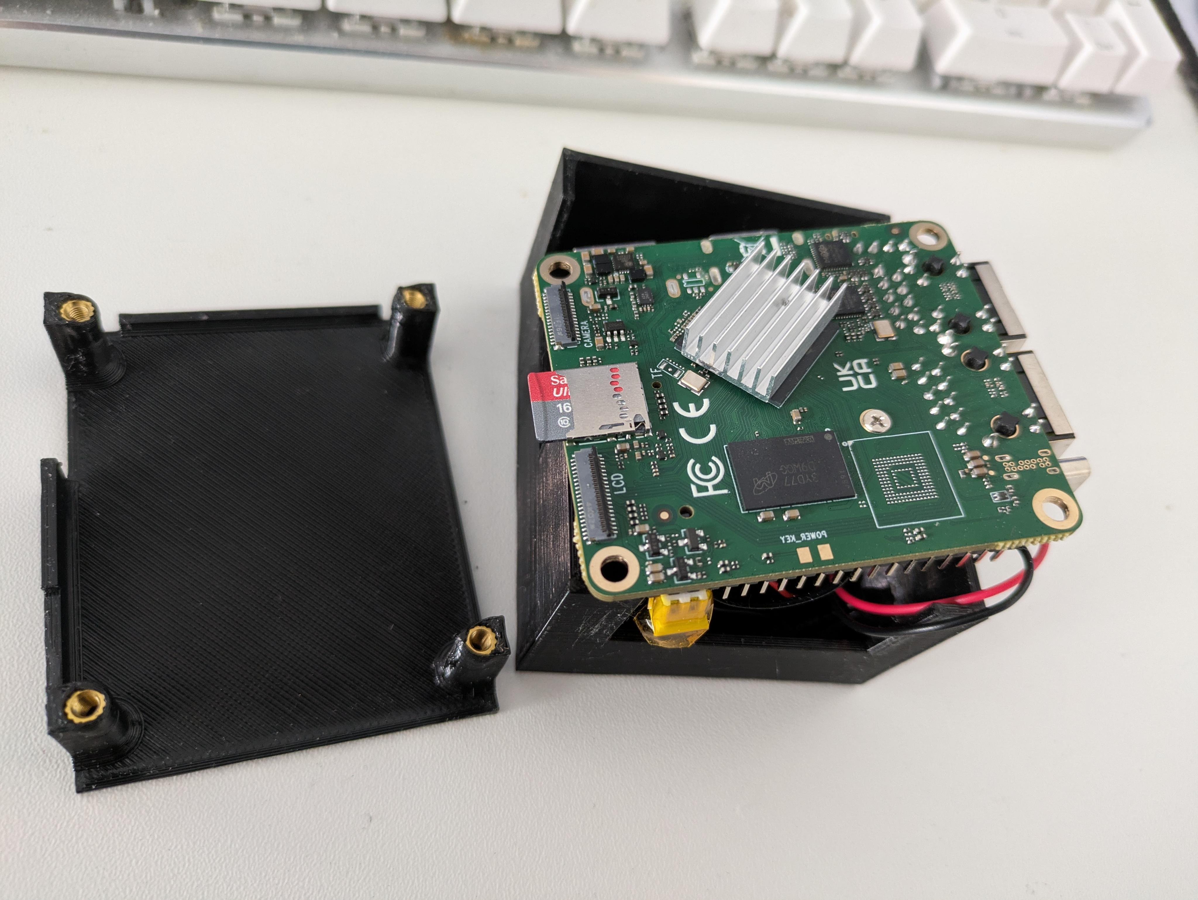

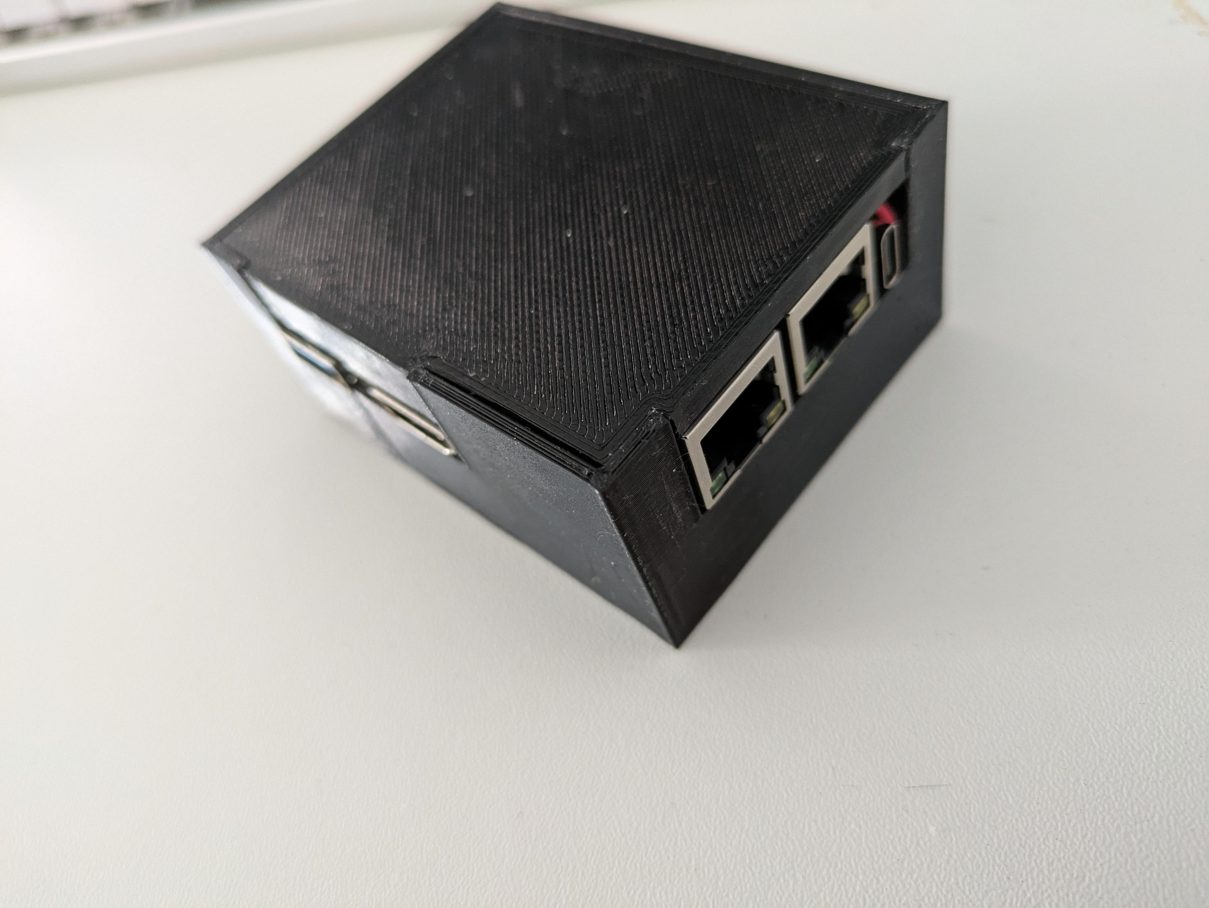

I did stick a small heat sink to the chip, together with a very slow, inaudible fan in a small case i designed for the cubie, it can run on full load without throttling.
You can find the case here: https://www.thingiverse.com/thing:7023900/files
Have fun!
Oooh! really cool, thank you! What are the dimensions of the fan and heatsink? Just so I can be sure it’ll fit into the case.
The fan is 40x40x8mm, the heat sink is 20x14x6mm. The heat sink could be larger, but not much thicker.
best

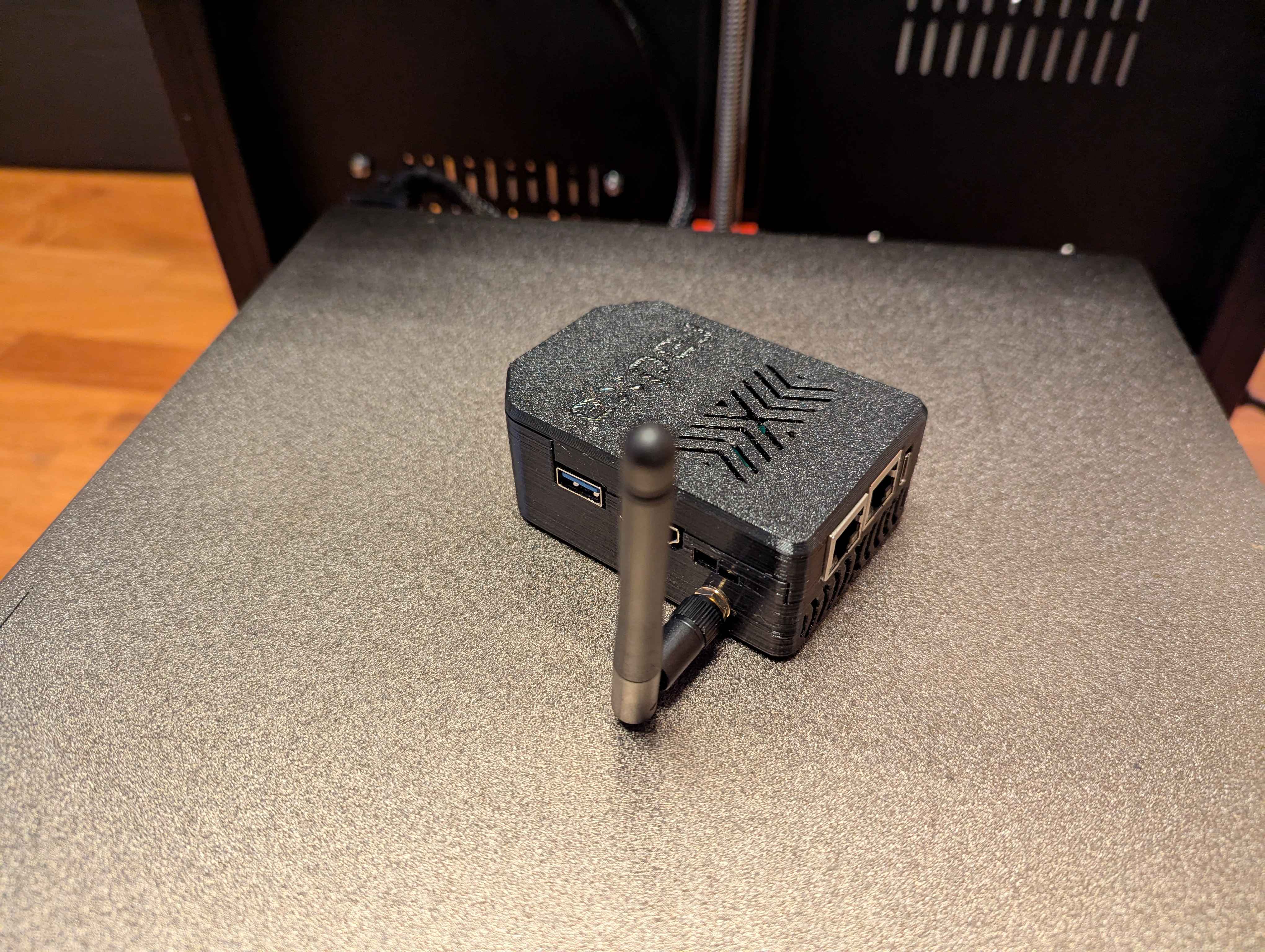

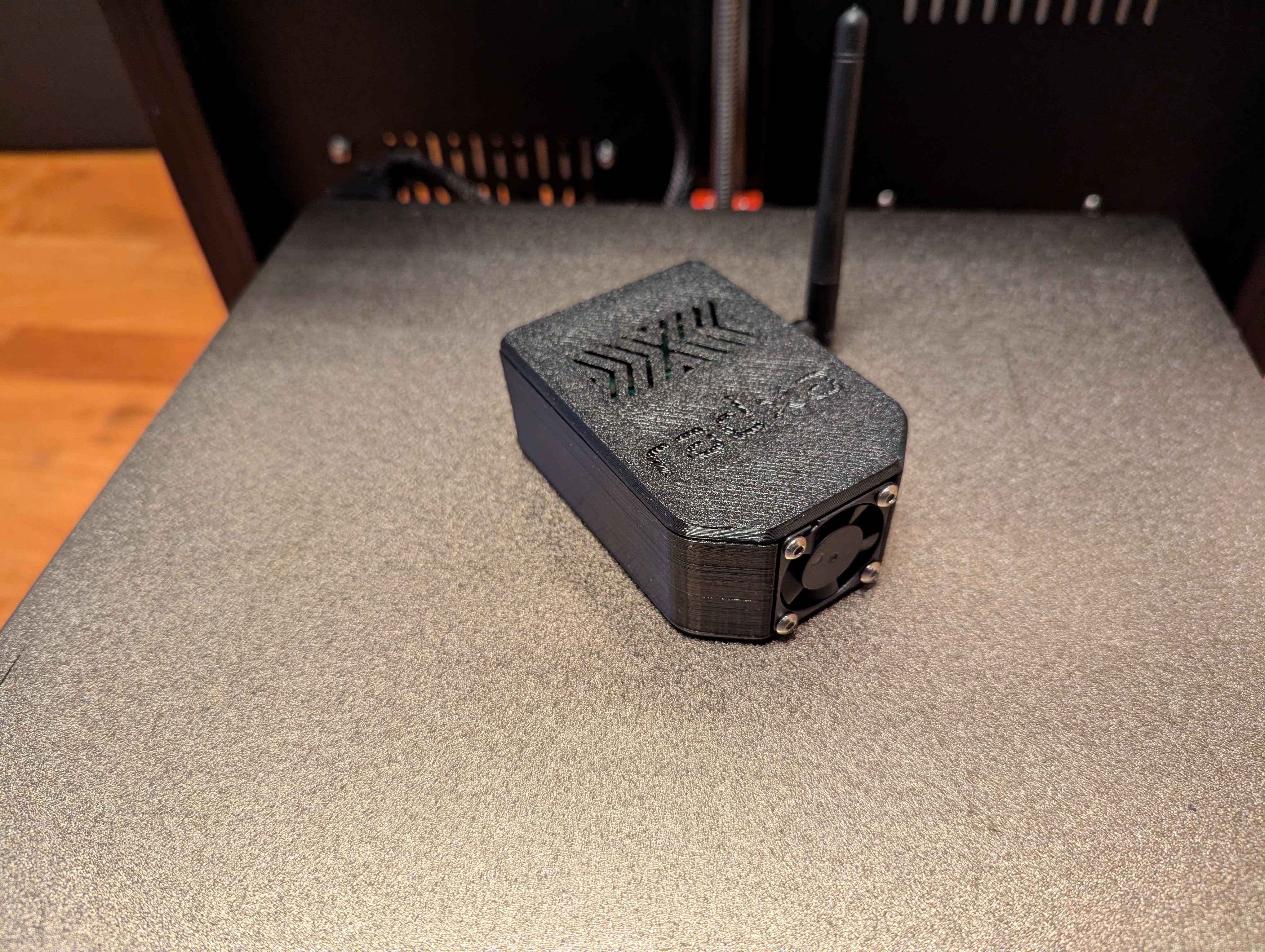

On Discord they shared these ones:
https://www.thingiverse.com/thing:6967864 https://www.thingiverse.com/thing:6967846

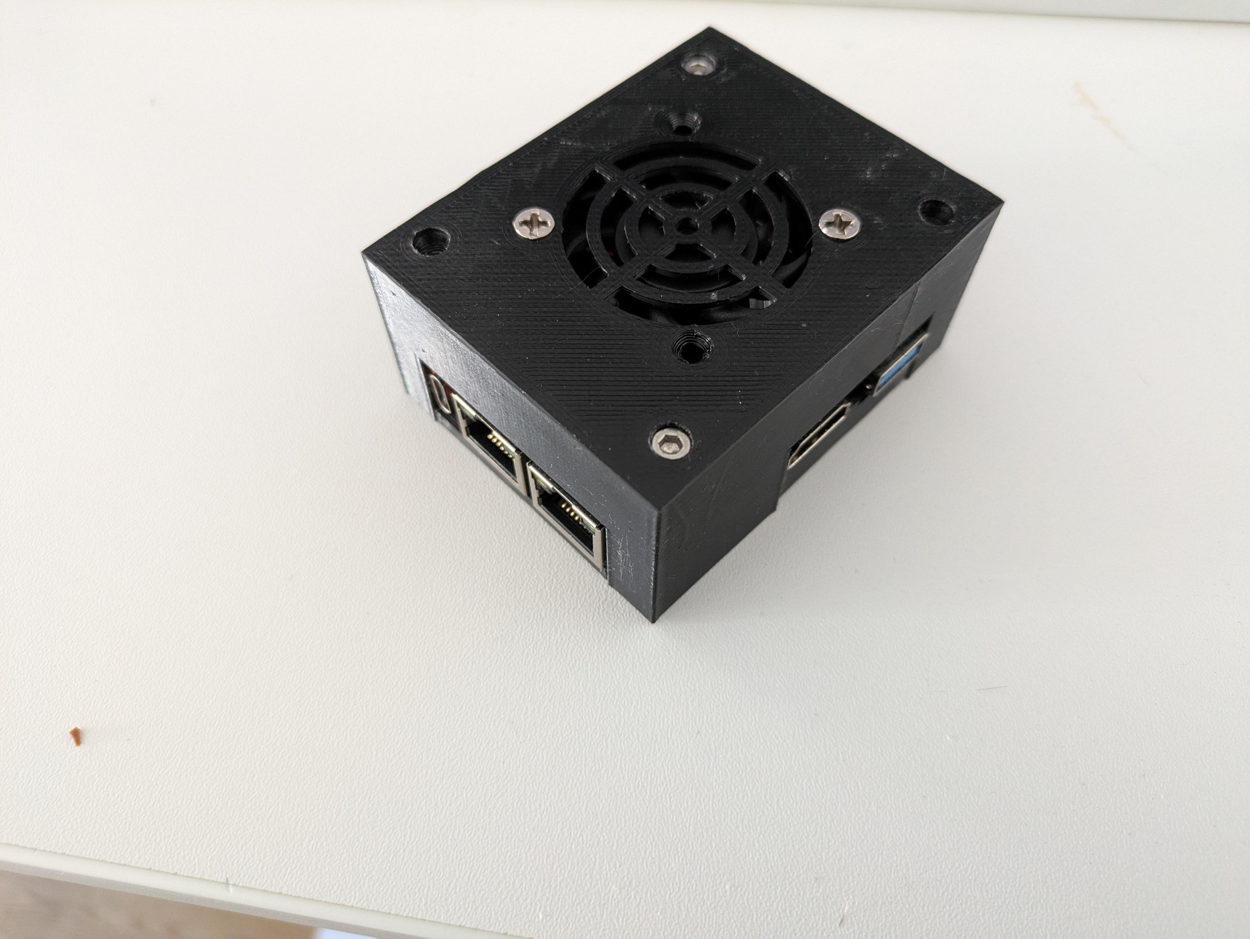

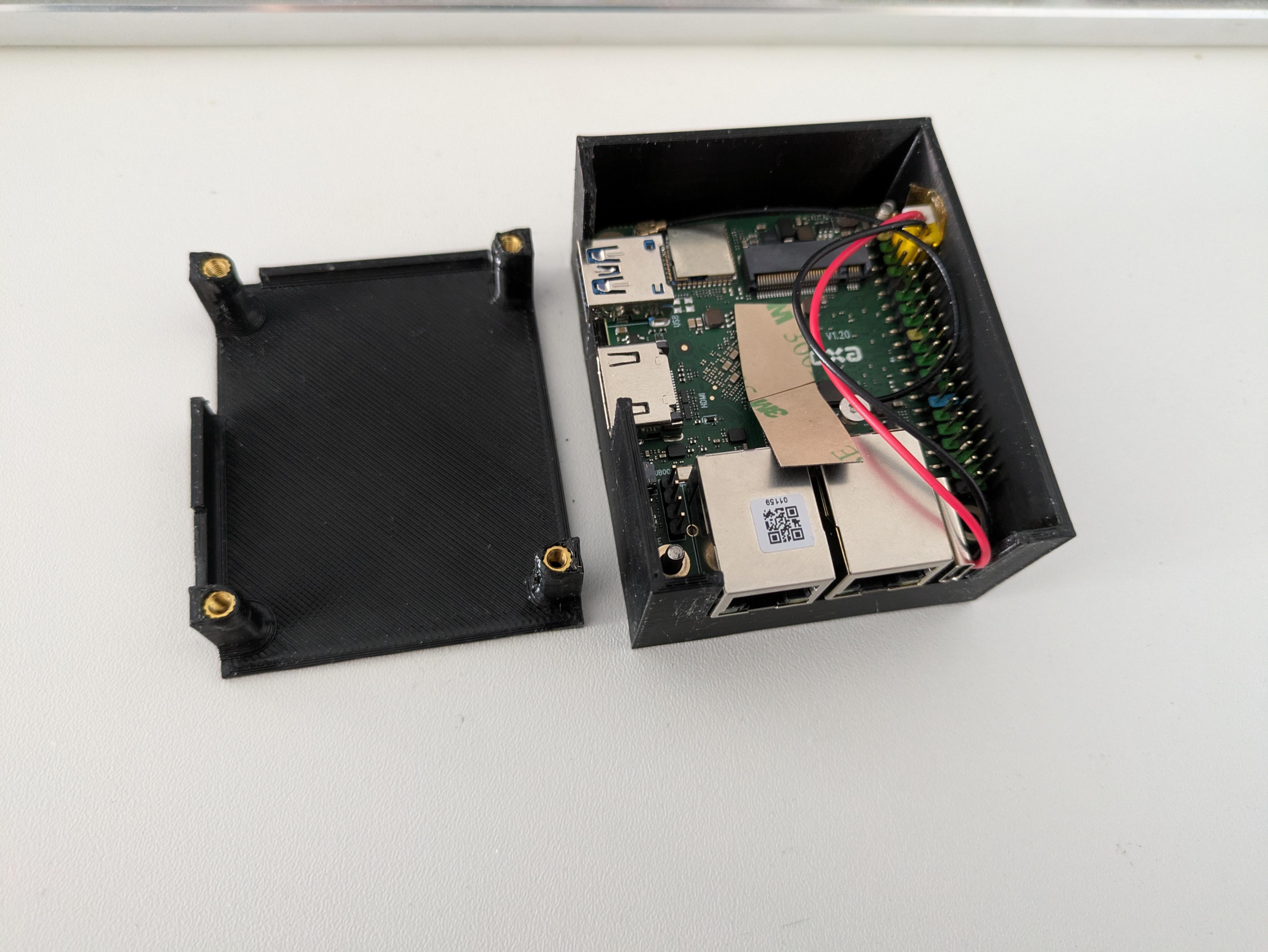

please share the nut and bolt dimensions as well, are these m3?
Yes, they are M3x20, on the other side I’m using threaded inserts that get heat-set into the print.
