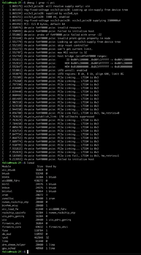

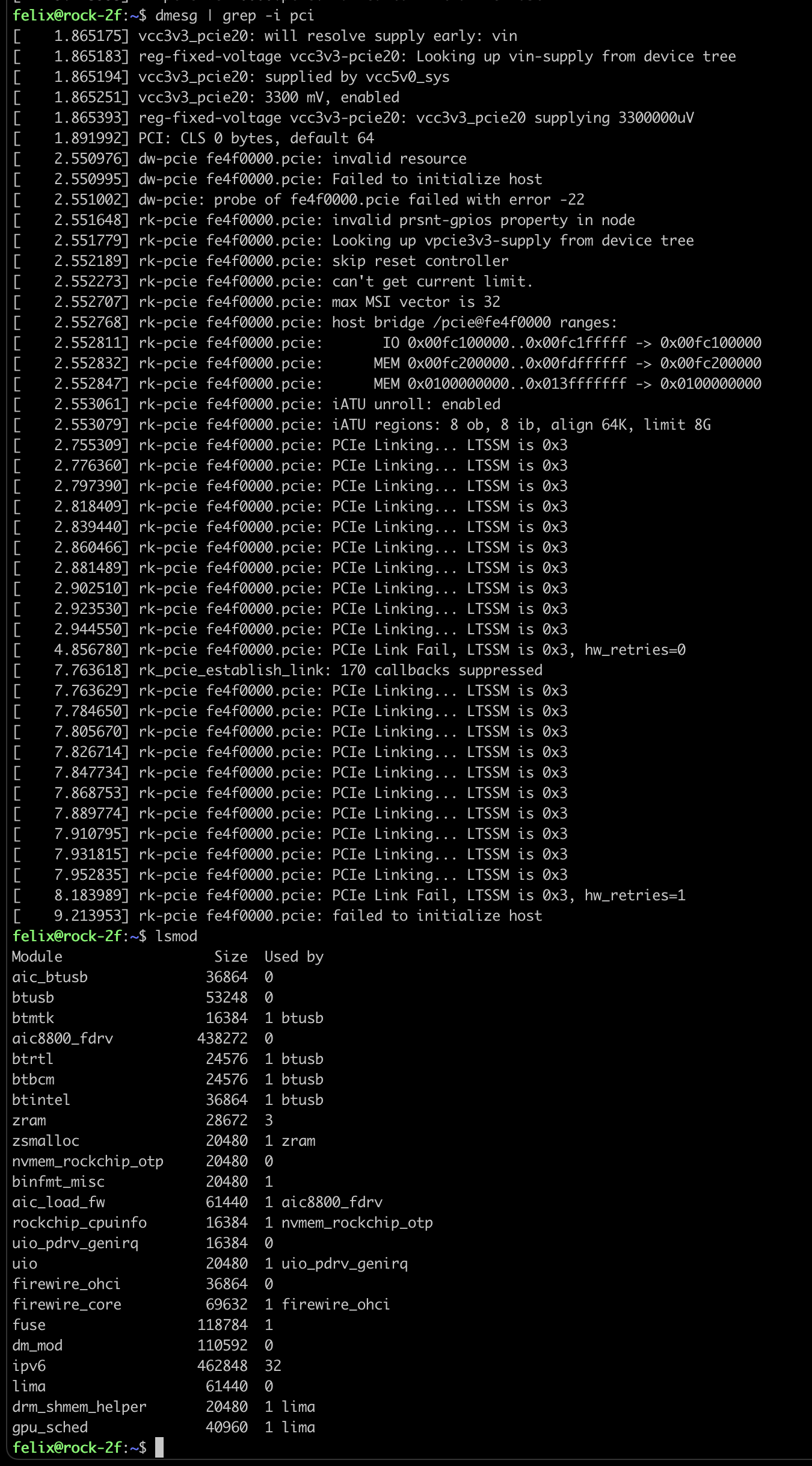

I’m running Armbian and rebuilt the kernel with the FireWire modules, but the card never shows up in lspci . I powered the adapter through its barrel jack, but still no luck.
Out of curiosity, I added an extender cable between the adapter and the card — it has a little LED that lights up when there’s power. This time I actually heard a faint noise, the Rock 2F got really hot, and I smelled a bit of burnt plastic. Oddly enough, it was also the first time the LED turned on.
