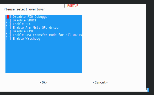

Thanks for the guide, however a freshly flashed release from the Image Download Page, fully updated via the “System Update” entry in rsetup, is missing the “Enable SPI Flash” entry image
same issue here missing “Enable SPI Flash” entry
