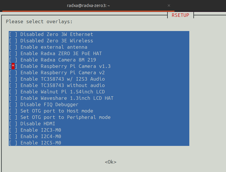

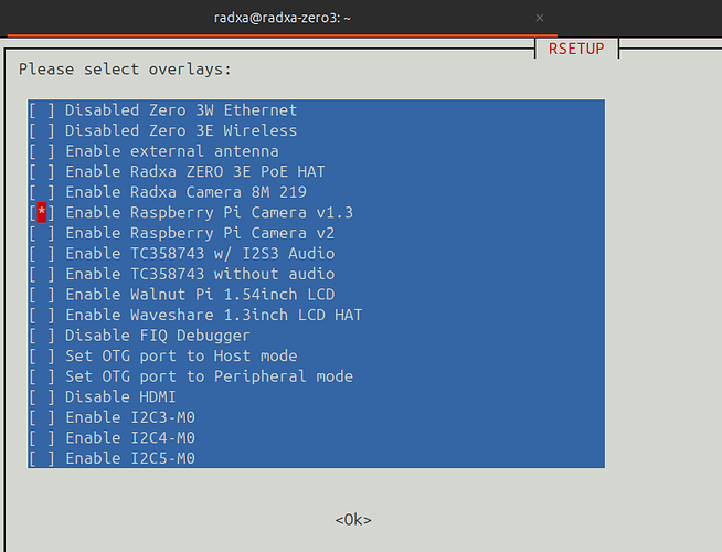

maybe you should enable the camera with rsetup?
radxa@radxa-zero3:~$ ls -la /dev/video-camera0
lrwxrwxrwx 1 root root 6 Jul 24 11:17 /dev/video-camera0 -> video0
I enable my camera on rsetup:
