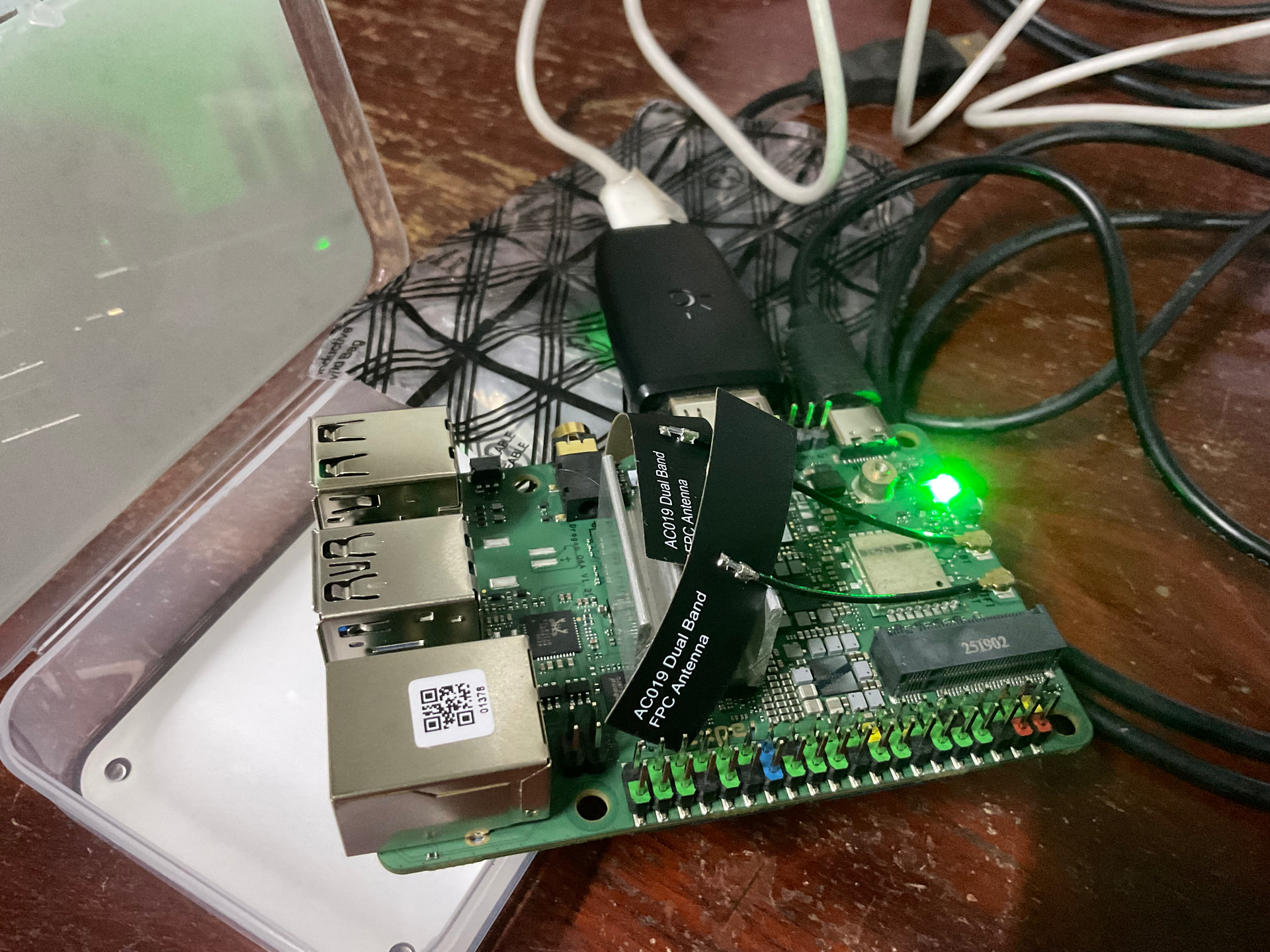

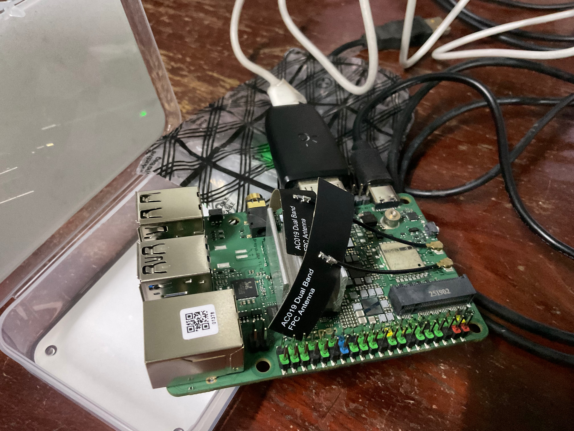

First time. I can boot on microsd but can’t use hdmi out. I can ping test. but can’t remote ssh. next step I try to reboot but nothing to response no hdmi, no ssh.
I try to reflash spi. First time to reflash can success but nothing to hdmi out. I try refresh again and fail between flash.
Board can enter recovery mode and can’t flash.
I change flash to other machine run on ubuntu 24.04 but can’t flash.
I used this link for download driver on windows.
Blink green light.

Please advice me. How to next step to recovery ?
Hi cluangar, I’m sorry to inform you that there appears to be a hardware issue with the DDR memory on your board. Please contact your retailer for a replacement.
ok. Thank you for your support. I bought from aliexpress and will contact to seller.
