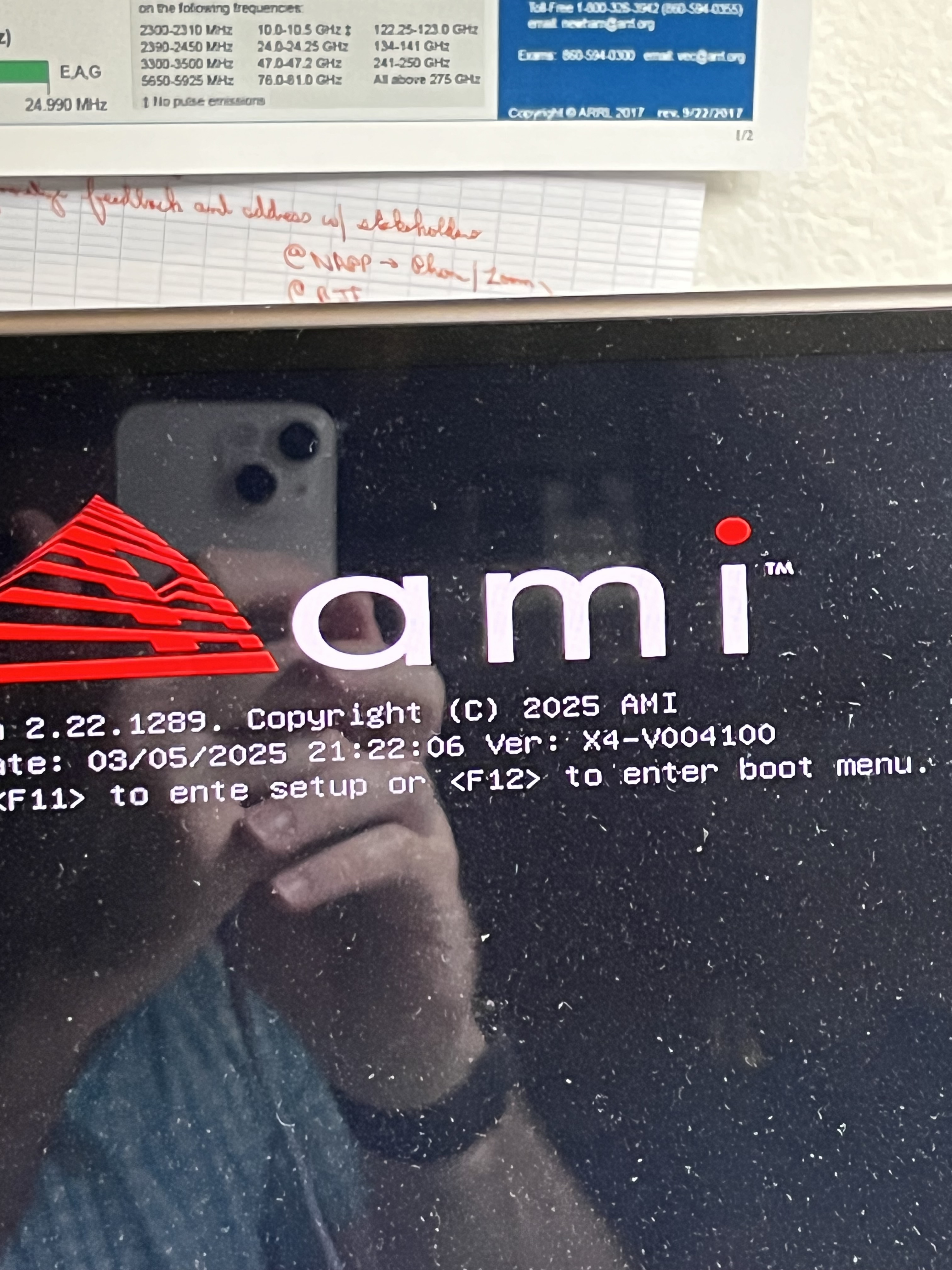

Hello,
I noticed a few typos on the startup splash screen. Two of them are rather severe.
  1. Should be press ENTER;
    2. The F11 key does not work to enter the BIOS. I had to press the DEL key.
    3. The F12 key does not work to get to the boot selector. The correct key appears to be F7.
cc: @ryann
I know pushing a new BIOS is a non-trivial task, but this could be really confusing for some people. I ended up thinking my keyboard wasn’t being recognized before the OS boot before I just randomly started trying F keys. Is it possible we could see a fix soon?
Thanks for your dig. This is a typo, we will fix it on next BIOS version
Normally RADXA logo will cover this screen, only when u Enable the quiet boot u can see this screen
The correct one is “DEL” key into BIOS, “F7” key into Boot Menu
