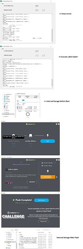

yes. i’m able to complete all the step in the guide starting from install driver for the board on my PC, connect the board as USB disk, erase the emmc & flash the image on it as in the link https://wiki.radxa.com/Zero/install/eMMC
Yes. i’m using Etcher to write the os into the emmc.
yes. together here i attach the screenshot for whole step.
