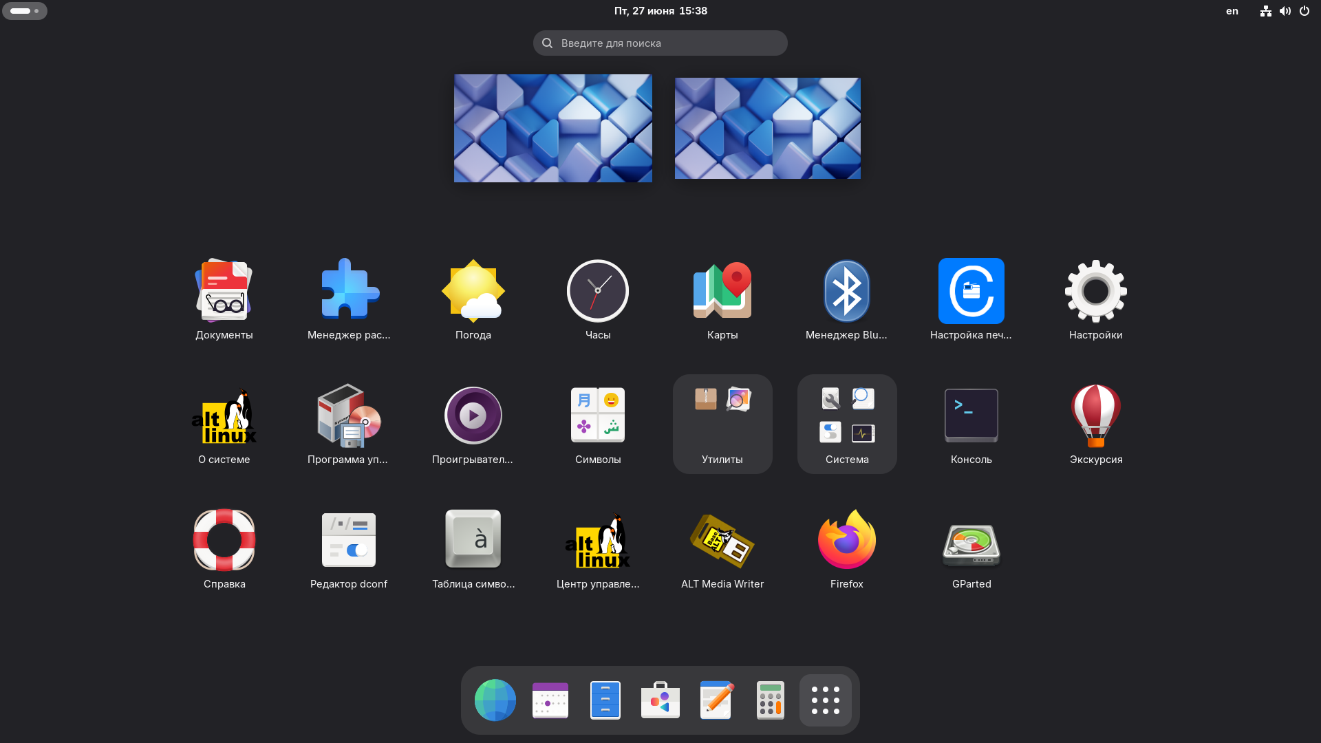

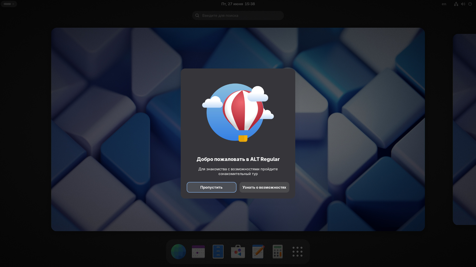

Launch AltLinux on Orion O6. Download image, unpack, burn to USB or NVMe. At the first launch, you need to go through the initial setup wizard.
Can find out more details or ask questions on the AltLinux forum.
