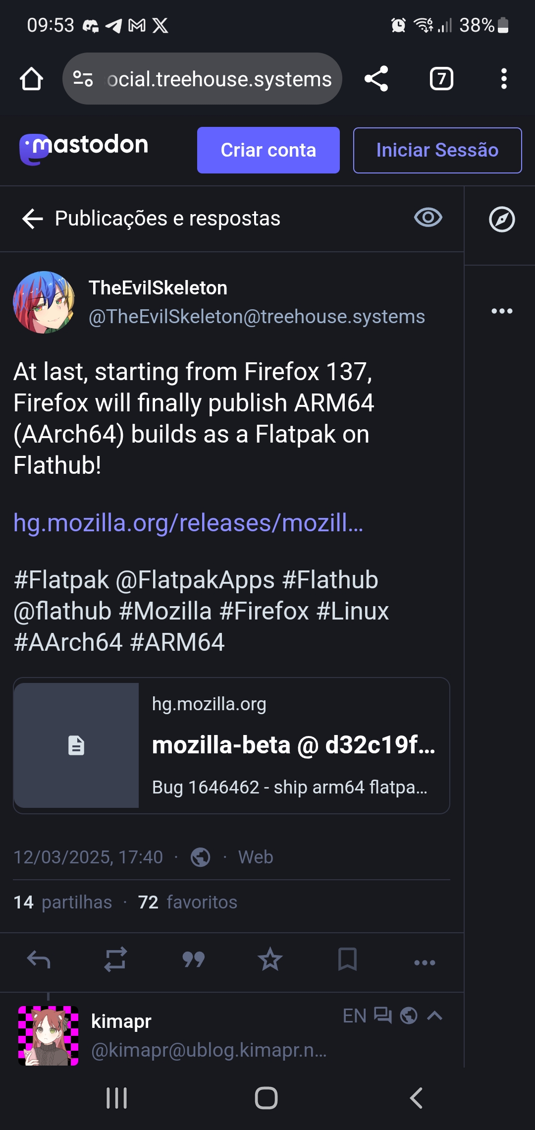

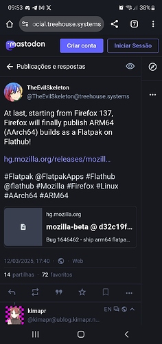

Also its available now on flathub too - Mainline with no HW Steroids
Thats mainline firefox it wont use mpp acceleration
