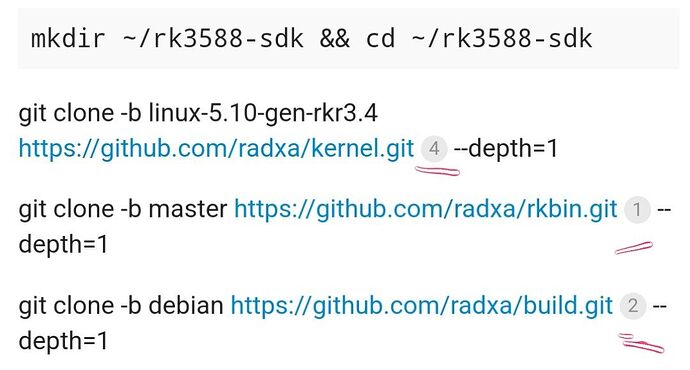

git clone -b linux-5.10-gen-rkr3.4 https://github.com/radxa/kernel.git  --depth=1
git clone -b master https://github.com/radxa/rkbin.git  --depth=1
git clone -b debian https://github.com/radxa/build.git  --depth=1
