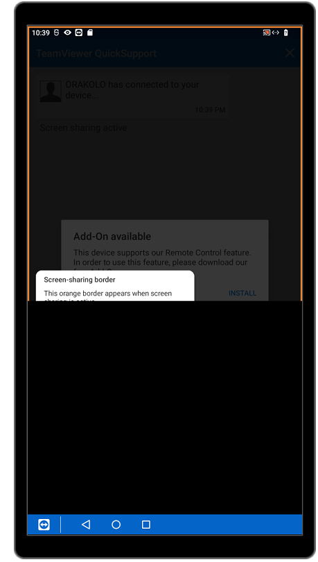

I built my custom image from Android12_Radxa_rk14 repository to a Rock 5B board and I changed the screen orientation to 270 because that is how my display is setup in the product.
It works fine, except when I connect via TeamViewer.
The screen is cut in half for the host:
Without rotation, it works fine, both screen and TeamViewer appear correct in landscape.
But when I change to portrait the problem appears.

The result is screen in portrait OK, but TeamViewer is cut in half.

I already changed the screen orientation and it works, but the issue I am facing is when using TeamViewer.
When the screen orientation is 270 the TeamViewer’s Host only shows half the screen:

I have the same issue with the latest image Rock5B_Android12_rkr14_20240419-gpt.
I tried also with anydesk, same behaviour. in portrait mode half screen is rendered.
