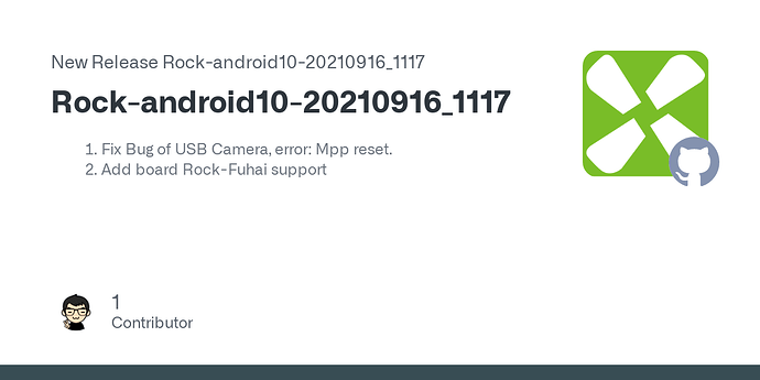

me too.
tried two images already:
https://github.com/radxa/manifests/releases/download/1.0.3/ROCKPI-4AB-2020-10-15-11-14-gpt.zip
https://github.com/radxa/manifests/releases/download/Rock-android10-20210916_1117/ROCKPI-4AB-2021-09-16-11-17-gpt.zip

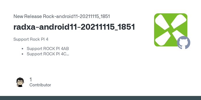

I would be helpful if you please share your kernel log and logcat.
Maybe have a try on new version.
Good night my friend, first I want to thank you for making these versions available to test, in relation to the versions available, version 10 did not work, it is eternally on the boot screen with the android logo animation.
Regarding version 11 it worked but it doesn’t have any standard video player like it has in other versions, I have an application that uses the native android media player, but here it doesn’t have any and everything is black. Is it possible to generate version 11 with native video player which is standard in all versions?
On 10 as I said it stays infinitely on the android screen and nothing else happens.
Thank you very much!
