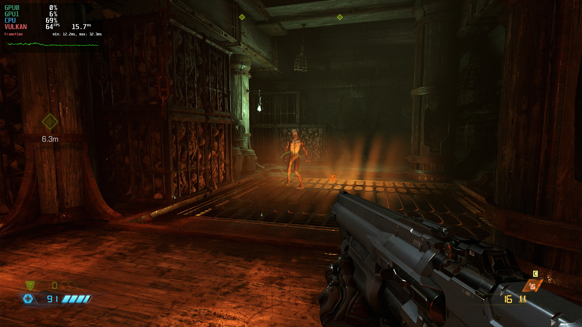

Doom Eternal:

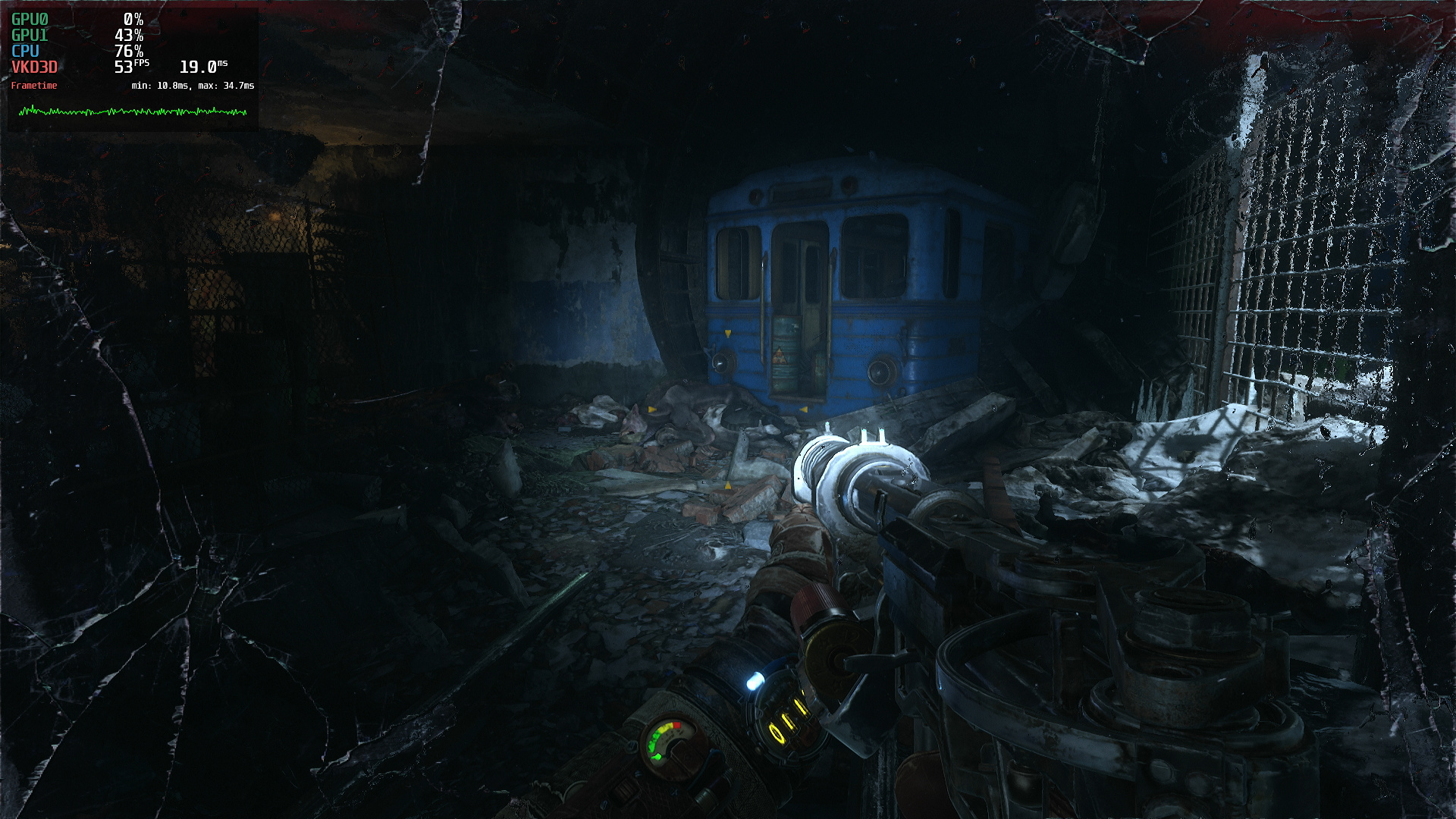

Metro Exodus:

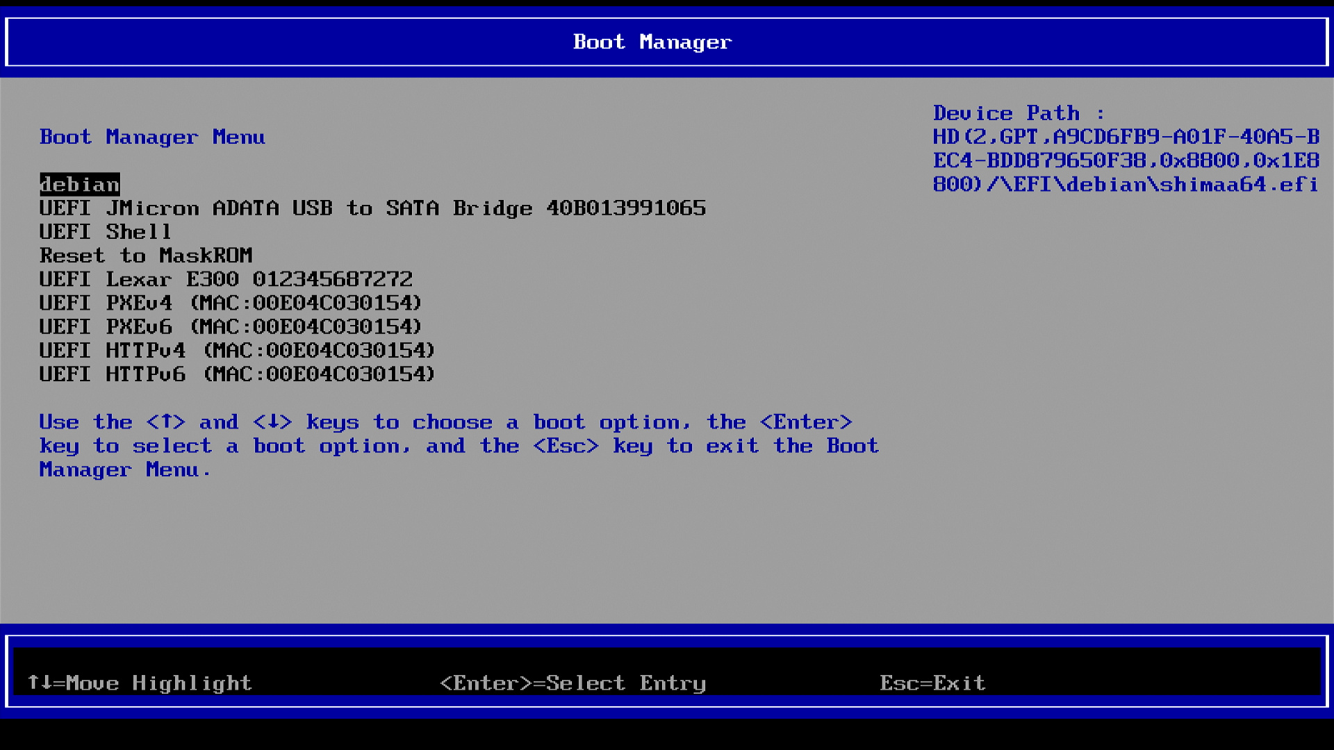

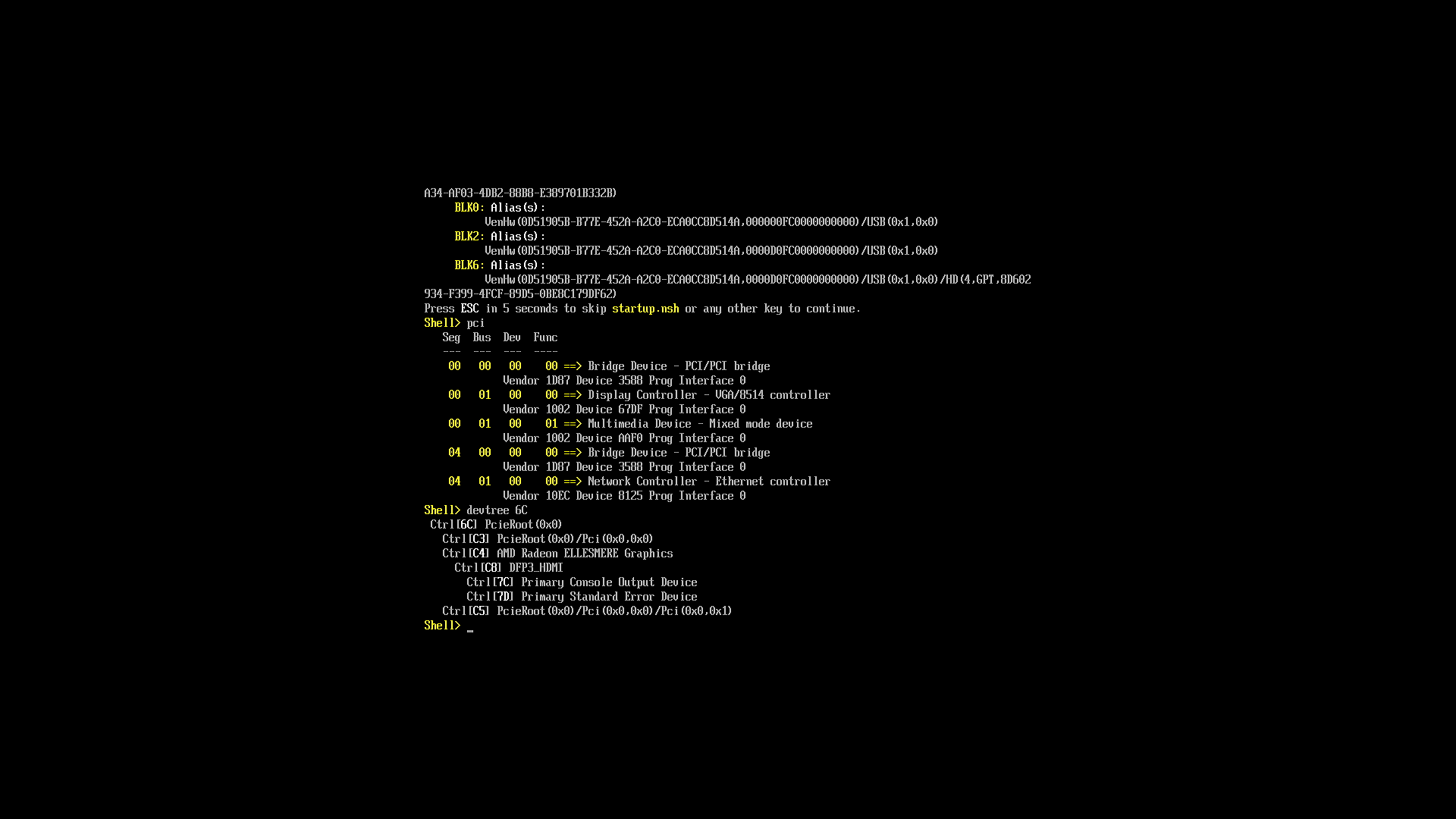

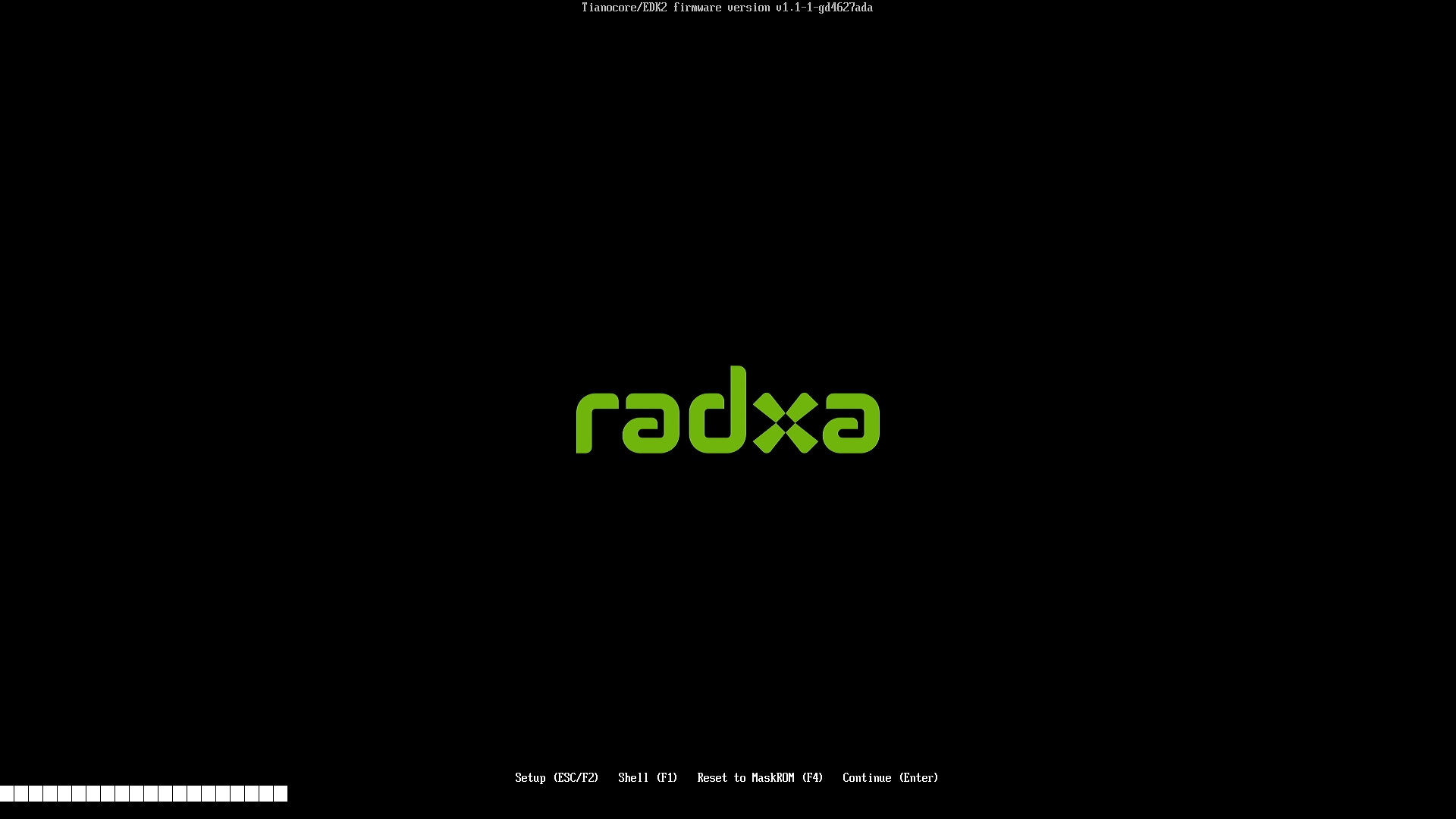

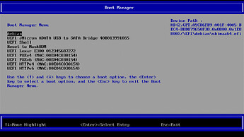

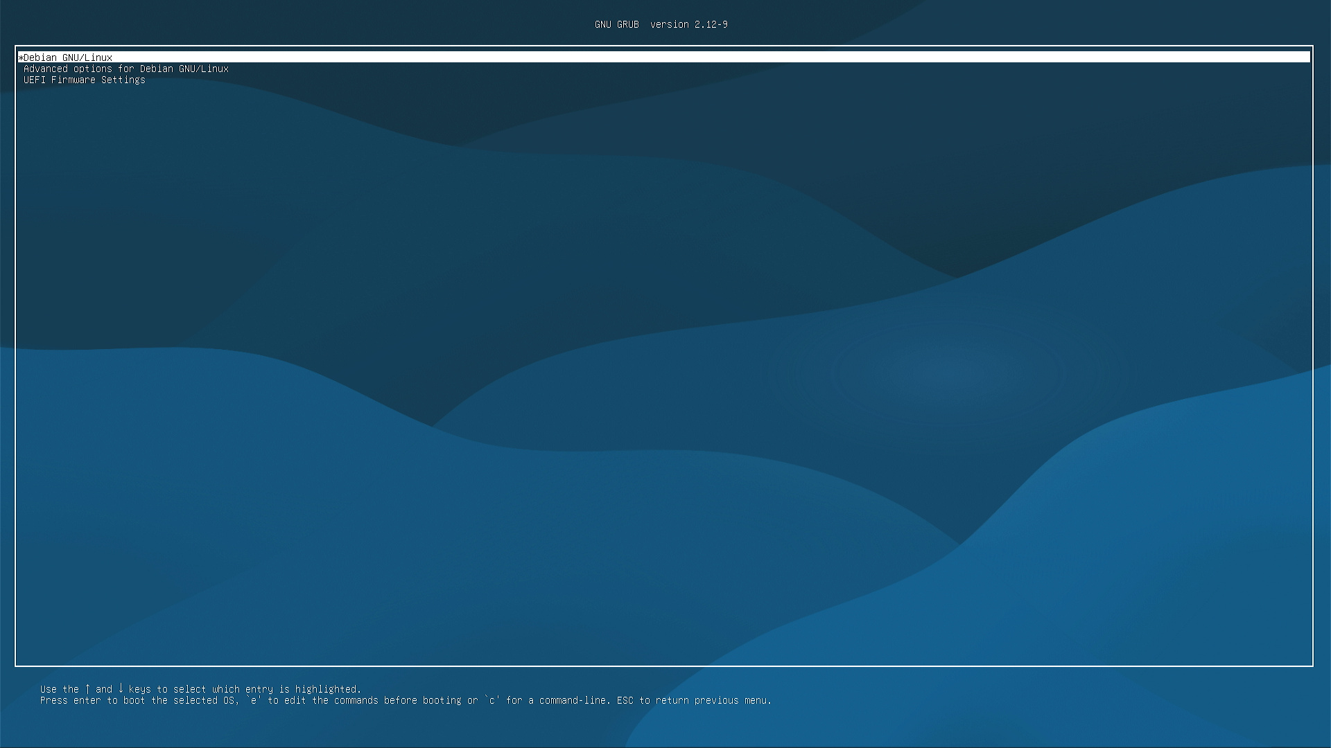

It even works inside the EDK2 UEFI:

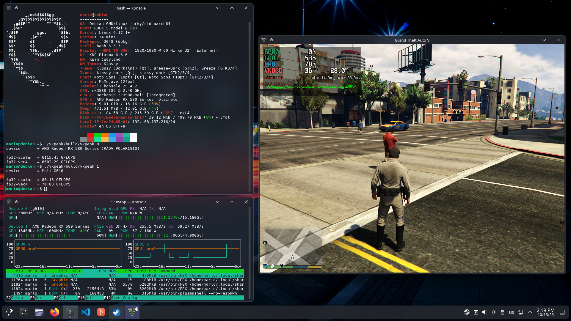

Is this on… Windows ARM?
Looks like KDE to me.
