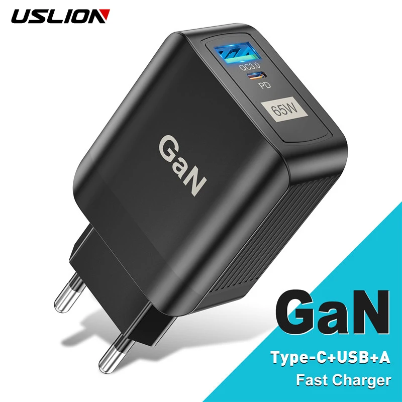

I was able to make use of my board with this cheap power supply, it provides 6.6A under 5V using the QC3.0 port (Type A port).
