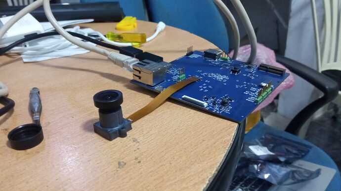

Unfortunately, i believe this sensor can’t work on Rock 3A, i think is 4 lanes, right?
But looking at the photo you provided i think it can work on Rock 5B, no idea about the necessary changes. What do you think?
If possible, and if you can disclose how to get one sensor with the FPC. No problem if you can’t disclose.
Hello Alexander, I got the sensor from Alibaba, I am pretty sure you would need a Hardware adapter to connect it to the Rock 3A or 5B. I use RK3566 but my custom board has 4 lanes so no problems on my end
I honestly see nothing special on IMX586, I just chose it because why not? But I ended up doing a lot of work finding a suitable driver and now this, making the camera engine work. I had decent knowledge on hardware design when I made the custom board ( over a year ago ), but I didn’t know barely anything about embedded Linux so I had no idea I was setting myself up for more work when I chose the IMX586.
