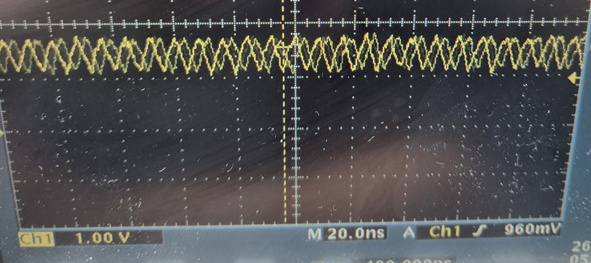

    We’re seeing signal problems on the GMAC0 TXCLK pin (GPIO2_B0).
2.1 Problem Conditions
When a 22Ω or 0Ω series resistor is added to TXC,
And we measure the waveform just before it exits the SoC,
The signal swings above an offset (e.g., around +1V ± 0.5V), not around 0V as expected.

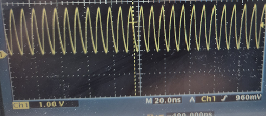

Meanwhile, the RXC signal appears normal.
Drive Level Test Results
drv_level_1: distorted waveform
From drv_level_5 and higher: waveform becomes normal only without the resistor
If a resistor is connected at TXC, even at drv_level_5, the signal starts swinging above an offset again.
