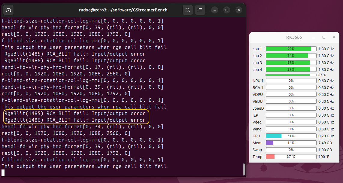

gst-launch-1.0 filesrc location=input.mp4 ! qtdemux ! h264parse ! queue max-size-buffers=1 ! mppvideodec fast-mode=true format=BGR ! queue ! autosinkvideo
It crashes on my machine, as it uses RGA.
As can be seen below, ffmpeg doesn’t use the RGA library, hence we get no errors.
GStreamer uses the RGA. Below a screen dump of the Radxa Zero 3W, the board without any problems.

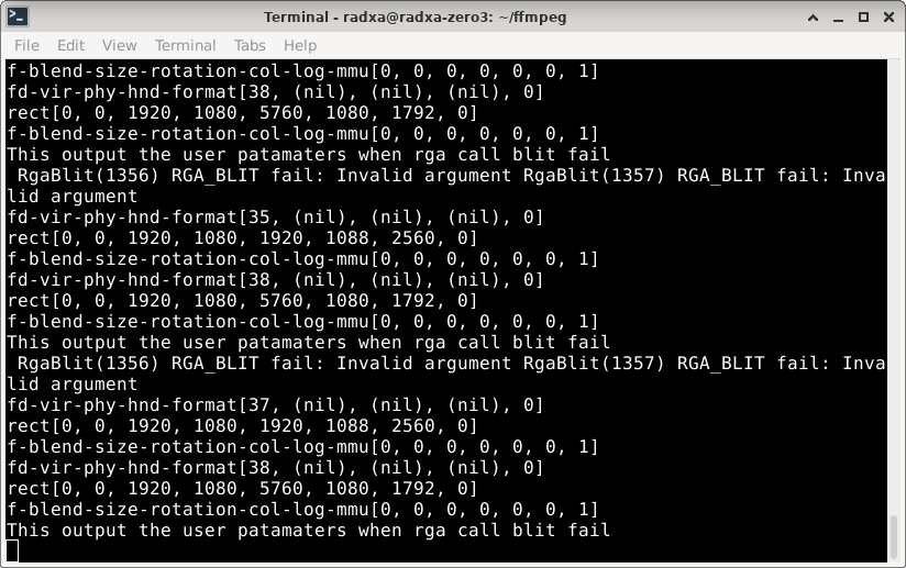

Below a screendump of ffmpeg with RGA enabled.
BTW, did you see the perfomance tool with your wonderful VPU utilization code?
That is a rare error code reported from the RGA. It should be an issue caused by device tree/kernel/hardware, because Zero 3W and 3E seem to only have differences in wireless/ethernet. There may be a conflict defined somewhere.

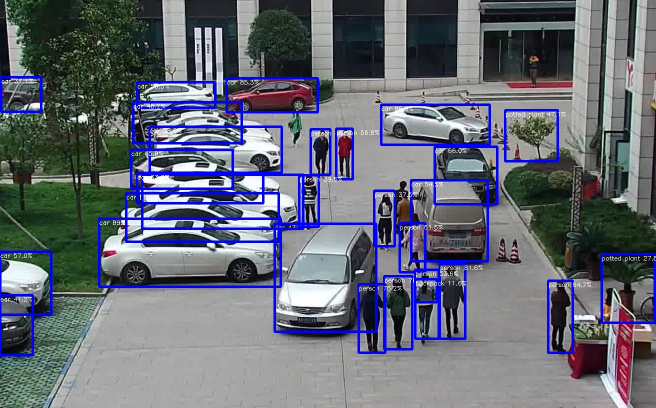

To get the ./rknn_yolov5_demo working with RGA, an image must be resized to 640x640.
Below the output generated by the Zero3W:

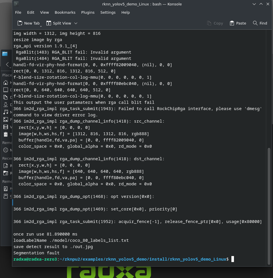

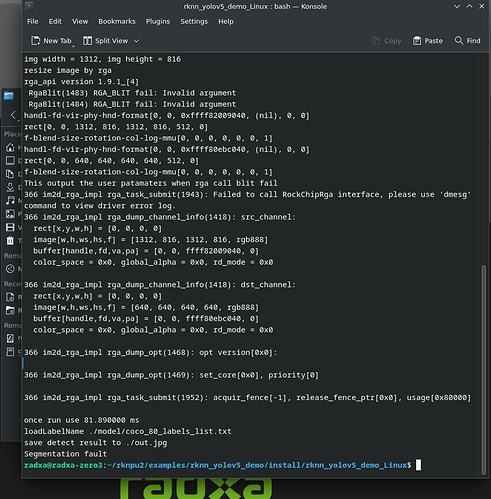

And this was the output of the Zero3E:
It still crashes when the RGA is called.
I must emphasize, I only swapped the SD card from the Zero3E to the Zero3W, noting on the card changed.
Hopefully it gives you a clue!
