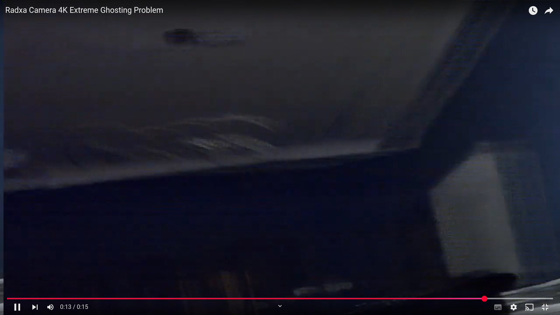

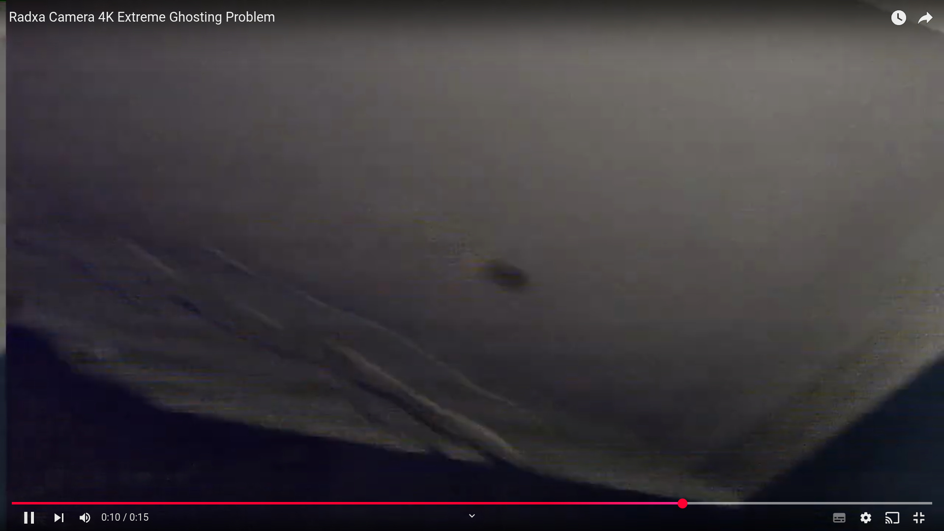

Hi, I tried the command, ghosting is still there. Those strange video artefacts in my video aren’t there, but the frames still seem to be overlayed on eachother for 1-2 seconds which creates the ghosting / washed out effect.
Please try again: mpv av://v4l2:/dev/video-camera0 --vo=gpu --profile=fast, if the problem still exists, it can be confirmed that the camera is the issue
There is still very faint ghosting which causes slight blurring, but it’s better than before with that command. If the previous command was 100%, this would be 10-20%.

The kde 5c image also started to work, I assume for the same reason (changing profile). I only have 1 camera to test with and not many SD cards to be able to quickly test things. Hopefully the above will help if someone else stumbles upon this. Disappointing result and not sure this can be used in a production setting without proper testing on various boards / cameras.
@stardust might interest you.
@RandomMaestro I used rock-5c for testing again and did not have this issue
Interesting.
I might have a faulty camera then since I’ve tried it on 2 different boards with the same issue.
Thank you for looking into it.
I know it’s been a while since I replied in this thread, and frankly speaking, that’s because I fully expected to be trash-talked. I’m glad I wasn’t. But I’d like to respond for future reference.
I only have an old low-quality video that I sent to Allnet on YT. I took screenshots from it. The quality is extremely poor, but they still show the issue very well. This is what the image looks like in reality.
Untrue, at least in my case. I tested with 5A, 5B, 5B+, 5C and 5C Lite while I still had access to them.
I’d also like to emphasize that when it comes to cameras, I tested multiple different units. An old one from nearly 2 years ago, and two newer ones from half a year ago.
To be fair, in the newest OS image for the 5C (after updates), the cameras work much, much better. There’s still some minor ghosting, minor color/lighting issues and a whole lot of pink noise, but it’s preferable to all that ghosting.
