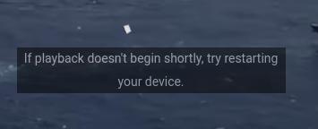

I am having a weird issue after an upgrade
Host
OS: Armbian 25.2.3 noble aarch64
Host: Rockchip RK3566 OPi 3B
Kernel: 6.1.75-vendor-rk35xx
Uptime: 11 mins
Packages: 2503 (dpkg)
Shell: bash 5.2.21
Resolution: 1920x1080
DE: GNOME 46.0
WM: Mutter
WM Theme: Adwaita
Theme: Adwaita [GTK2/3]
Icons: Numix-Circle [GTK2/3]
Terminal: gnome-terminal
CPU: (4) @ 1.992GHz
Memory: 1559MiB / 3919MiB
My chromium reports
Graphics Feature Status
*   Canvas: Hardware accelerated
*   Canvas out-of-process rasterization: Enabled
*   Direct Rendering Display Compositor: Disabled
*   Compositing: Hardware accelerated
*   Multiple Raster Threads: Enabled
*   OpenGL: Enabled
*   Rasterization: Hardware accelerated on all pages
*   Raw Draw: Disabled
*   Skia Graphite: Disabled
*   Video Decode: Hardware accelerated
*   Video Encode: Software only. Hardware acceleration disabled
*   Vulkan: Disabled
*   WebGL: Hardware accelerated
*   WebGL2: Hardware accelerated
*   WebGPU: Disabled
*   WebNN: Disabled
Video Acceleration Information
Decoding            :
Decode hevc main    : 48x48 to 3840x2160 pixels
Decode hevc main 10 : 48x48 to 3840x2160 pixels
Decode h264 baseline: 48x48 to 3840x2160 pixels
Decode h264 main    : 48x48 to 3840x2160 pixels
Decode h264 high    : 48x48 to 3840x2160 pixels
Decode vp8          : 48x48 to 3840x2160 pixels
Decode vp9 profile0 : 48x48 to 3840x2160 pixels
Encoding            :
Vulkan Information
Device Performance Information
Log Messages
[4121:4121:0405/153331.357486:WARNING:sandbox_linux.cc(430)] : InitializeSandbox() called with multiple threads in process gpu-process.
[4121:4121:0405/153331.365064:WARNING:viz_main_impl.cc(85)] : VizNullHypothesis is disabled (not a warning)
[4121:4675:0405/153710.944604:VERBOSE1:gpu_video_encode_accelerator_factory.cc(232)] : GetSupportedProfiles(): Supported profiles empty, querying again...
[4121:4121:0405/153711.082423:ERROR:gl_display.cc(493)] : EGL Driver message (Error) eglCreateContext: Requested version is not supported
But when I play youtube, this error happens
