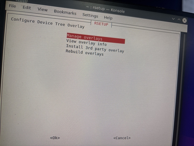

This work when i power up with additional power source its boot but another a issue its detect 2.0 but radxa a5e have 3.0 usb but not gaining 3.0 speed so my system run slow laggy is any solution
For activate USB 3.0 you must use overlay. rsetup - overlays - overlays managment… etc.
In overlays show this how to set usb 3.0
What next? What menu appears next if you select “manage overlays”. Perhaps then a list of overlays will appear, among which will be the one you need? Which you will need to apply and reboot the device. MAGIC.
