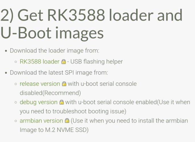

Well by taking out options I believe there is still something about these files:
I have only tried the release version and not the armbian version since its made for nvme might help? Maybe not but… its the only thing I am seeing that could fix this maybe.

This is the bootloader for arm I used: https://github.com/huazi-yg/rock5b
https://github.com/huazi-yg/rock5b/releases/download/rock5b/rkspi_loader.img
I got this image from this forum.
I found this link: https://wiki.radxa.com/Rock5/guide/build-u-boot-on-5b
DarkevilPT, can you share the link to the prebuilt images that you reference here. I’m having a hard time finding wiki page with it.
Yes Sir. I do the windows method but linux ninjas do the easy wey:
https://wiki.radxa.com/Rock5/install/spi#Advanced_.28external.29_method
Either way works.. and I must say.. I did it yesterday and so far so good … but I did in the past and idk what triggers the hanging but this only fixes it ‘temporarly’ idk.. But do try it and u will notice it will reboot fine.

I found the issue. For those who are trying to run Arbmian with only a nvme drive (no mcirosd). It is NOT a power supply problem.
The issue:
If you follow this guide (https://wiki.radxa.com/Rock5/guide/build-u-boot-on-5b) and compile your boot loader, or you use a spl_loader image thats pre built. The rcok5b will NOT boot without an mic-sd card present.
Then you will look around and someone will point you to this spl flash image.
The problem is this boot loader. Something is wrong with it regarding reboot. Using this boot loader causes inconsistent reboot. Sometimes it will boot sometimes it will hang up.
If you boot with the other boot loaders using an sd card. Rebooting works.
