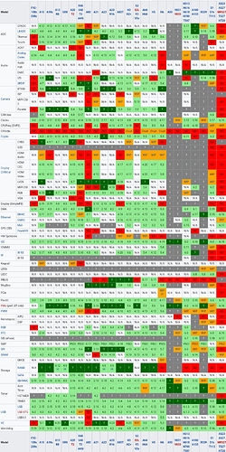

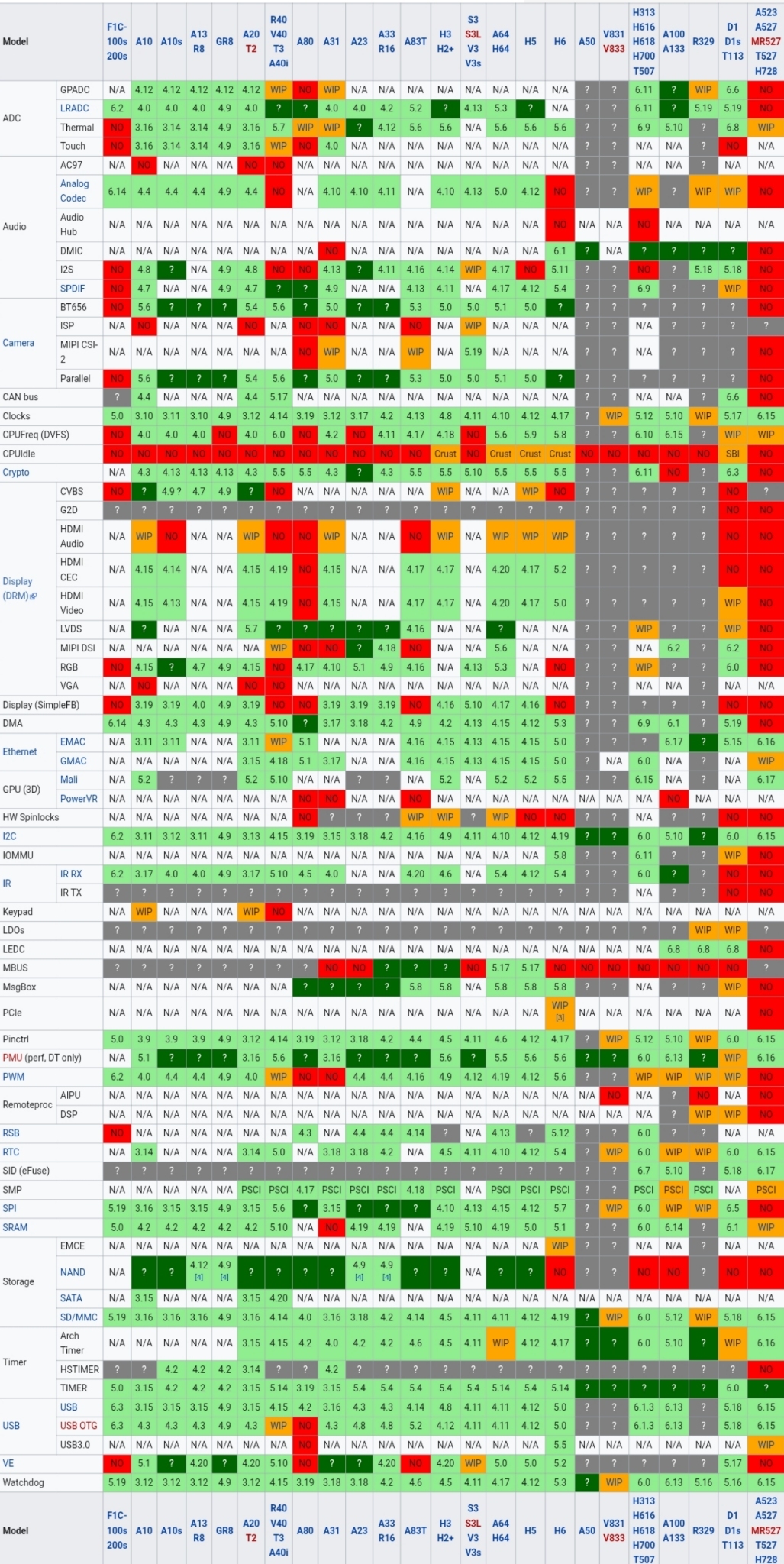

A733 is not even in that table yet and for A5e this looks mostly red :confused:
