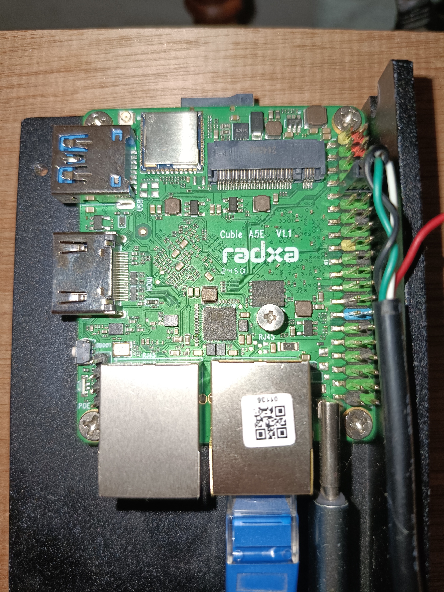

@Juan_esf91
Hi Juan, may I check with you what is your cubie board version number?
I am asking because my just-received A5E V1.20 board couldn’t boot the Armbian you provide
(I have tried the one you shared via google drive Armbian_community_25.5.0-trunk.256_Radxa-cubie-a5e_bookworm_dev_6.14.0-rc1_minimal.img.xz and also the
Armbian_community_25.8.0-trunk.245_Radxa-cubie-a5e_bookworm_dev_6.14.0-rc1_minimal.img.xz currently on Armbian website)
Both of the image the board led just keep long green (no flash, no other colour)
I couldn’t get the pre-built images to boot either, but an image i built myself booted ok.
Here’s the options for the armbian build tools - Might work with others, but this is what worked for me.
./compile.sh build BOARD=radxa-cubie-a5e BRANCH=dev BUILD_DESKTOP=no BUILD_MINIMAL=no KERNEL_CONFIGURE=no RELEASE=bookworm
Thank you David, I will have a try.
Would you mind having a look what is the version number of your A5E printed on the board?
Mine says v1.20
@David_Coulson blindly guess yours is also 1GB?
I read some source said A5E 1GB has booting problem with Armbian. some source
