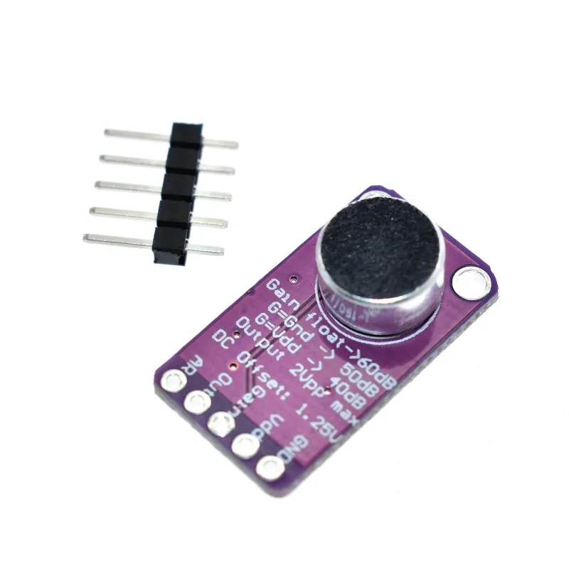

Its not all bad as the electret modules you can get are far better than that, but I just wanted to ask is that the results you get?
